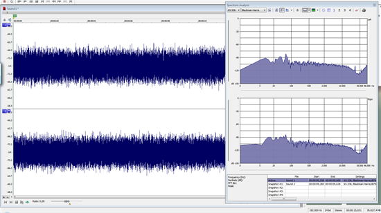

I'm using PCM5310 for 4CH audio IN and OUT. I have external out of band noise filters (active 2nd order, fc=24kHz and pasive RC fc~30kHz). Power supply is clean, I have decoupling capacitor pairs (2u2 and 100nF) as close as possible on every power supply pin, and 1uF ceramic on VCOM pins (AD, DA...). Ground is connected under device as suggested. I'm using 9V for line output drivers.
When I route PCM5310 LINEIN12->LINEOUT12 then there is no audible noise present (~ -90dB).
As soon as I configure codec and unmute it (and without any digital data or clocks present on any digital ports), there is a constant white noise present at around -74dB measured with RME fireface audio card mixer (with input gain set exactly, so that maximum signal level reaches around 0dB).
If I provide some clock input and zero DATA, then noise rises for another 3dB to -71dB.
Codec is configured and running as 48kHz, 24bit I2S, all CLK ports are in SLAVE mode configured as inputs, and ALL ADC & DACs uses same slock source from digital port 2. Codec is used without deemphasis, in 64x oversampling mode, and there are no audible pops and clicks due to some clock settings mismatch, and audio sounds OK otherwise.
Noise is independent on digital attenuation level setting for DAC12 and DAC34, so it must come from DAC section or after.
What could be causing so much noise ?

I'm attaching image of recorded audio signal levels and its spectrum.

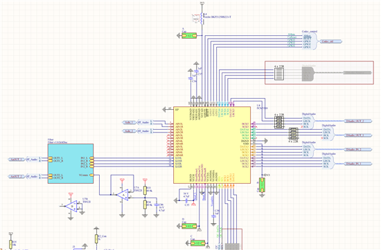

    Would you be able to attach a schematic, and a BOM/layout?  Are all of the grounds tied under the chip, or just some of them?  Also, can you notice any improvement when increasing the value of the decoupling capacitors to 4.7uF or greater?
  • Hi Patrick,
    I tried to do all of those things, but noise level was exactly the same:
    - Added some decoupling capacitors (I already had combination of 100nF+4u7 on every power supply pin)
    - Stopped all digital clocks (LRCK, BCK, DATA) except system clock
    - Provided external system clock (not correct 12.288MHz, but 10,9,8,7 and 20MHz), but noise was everytime the same
    - Disconnected my TPS65270 based DC-DC power supply and provided external 3.3V laboratory power supply
    - Added/removed 470uF low ESR tantalum bypass capacitor on 3.3V supply
    - Replaced ferrite chip beads with coil or straight connection without ferrite chip bead
    - Replaced external 9V power supply with 9V battery
    Noise level on headphone output is lower, but signal levels are also lower in ~same relation.
    All of the ground pins are connected directly under the chip.
    I'll post layout and schematic as soon as I get approval, but is it possible to send them just to your email? (this I can do immediately)
    Best regards, Darko Obretan

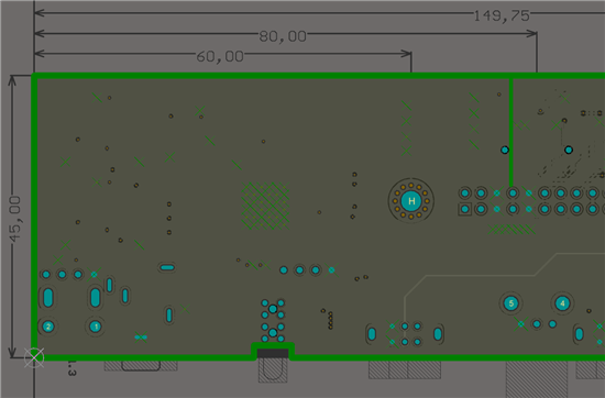

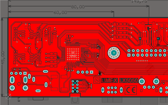

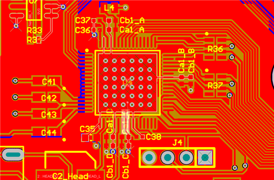

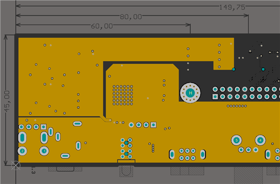

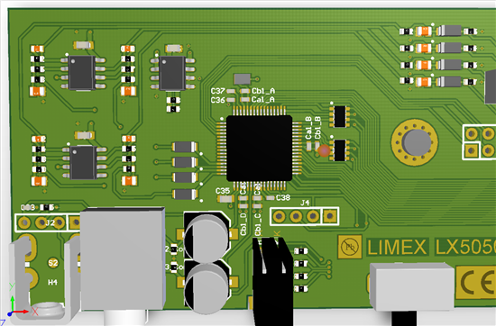

  • Hi Patrick,
    I'm posting PCB layout:
    Any ideas appreciated.
