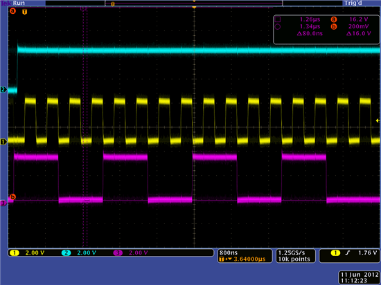

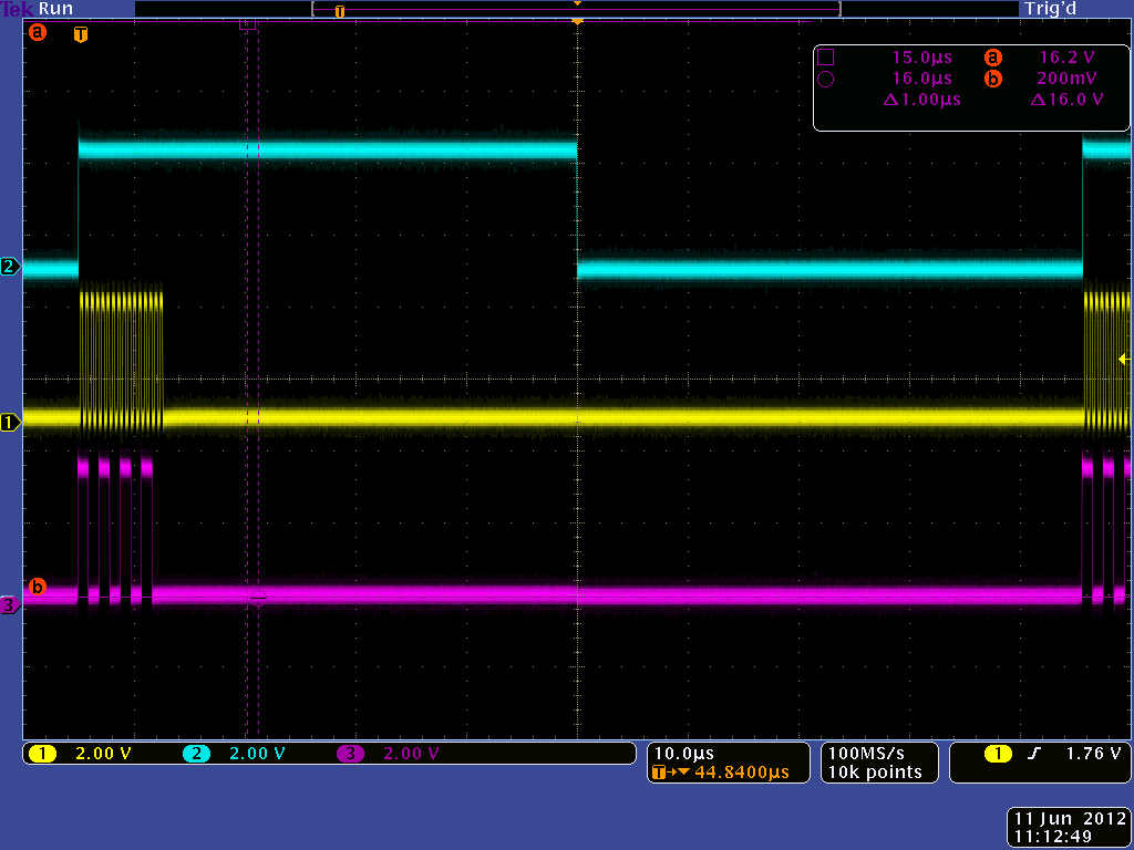

    This is the digital audio outputs from the Stellaris:
    First is WCLK, second is BCLK and third is DIN.
     I am sending 0xCCCC (DIN). This seems to be exactly what the DAC is looking for.... but the output is still 0v.
    When I mess around with WCLK, sending just a pulse, and DIN, sending a sweep, for example, the DAC outputs a regular signal at the sweep's frequency, but the signal is non-sense. That means the clock is well configured, isn't it?
