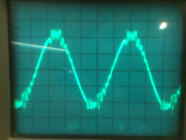

Received the TI evaluation module. Sine wave testing, there is considerable oscillation that occurs at the onset of clipping.

Hi, Bruce,
Are you looking singled-endedly (is that a word?) or differentially? Can you post a screen shot?

Bruce,
That looks pretty normal... Measure it differentially, and you'll see a nice, smooth, clipping waveform, just as you'd expect.
