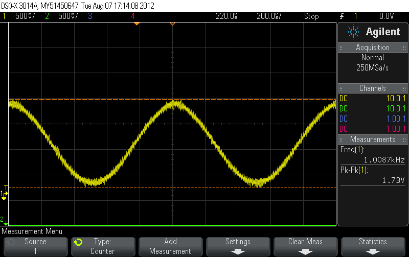

We are using the TLV320AIC3254 DAC for testing the wav file given.We sees the strange thing happening in the DAC input and the output side.
BCLK = 3.072Mhz
WCLK = 48KHz
I2S Right justified 16 bit word
Scenario 1:
Input sample of 1KHz 16 bit - In output of the DAC we see the positive drip and noise is added in the output sample in osicilloscope
Scenario 2:
Input sample of 10KHz 16 bit - In output of the DAC noise is added and frequency is reduced to 400HZ in osicilloscope.
Input sample from above 6KHz we are seeing the output sample frequency reducing.When this kind of strange behavior will be aloowed in thw DAC.
Is there any configuration and CLOCK related stuff needs to be changed ?????
