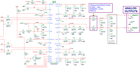

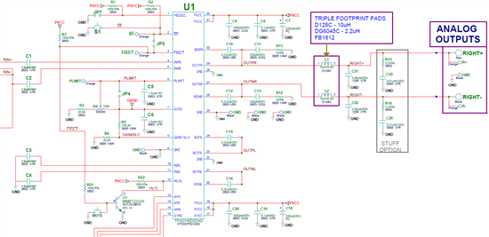

  • Hello, Sakai-san. I can see why you would want to use PBTL after looking at the Mono Mode section of the data sheet. Fortunately, you can use BTL instead of PBTL to drive a 4 Ω load, so you'll need fewer components to achieve the results you want. I've come up with two adapted schematics to show you how to do this, one of them I prefer.
    This first schematic assumes you are using a single channel of audio input. In this case, we can remove the snubbers at the left switching output. I prefer this design, because with no left audio input, there isn't a left switching output, and the chip does not need to work as much.
    This second schematic assumes you use a left and right input into your audio system. The left audio channel will not appear at the speaker (because only the right channel will reach the speaker in this schematic; see the TPA3116D2 block diagram in the data sheet for details), but the schematic has all the components you would need to route the left audio to a switching output, and not have it go to a speaker.

  • Hello, Sakai-san. That is more power supply current than I would expect for not having a load, but it isn't outrageously larger than I would expect.
    To answer your questions:
    1. The "C" version of the TPA3130D2 EVM is different from the "B" version. I have attached its schematic below this sentence. I am sorry that it wasn't available in the User's Guide. I am working to fix this.
      8562.TPA3130D2 EVM Schematic Rev C.pdf
    2. The following headers require shunts across them: AM0, AM1, AM2, JP1, JP2, JP3, JP4, and MODSEL.
    For PBTL mode, yes, use RIN only. I recommend connecting INPL and INNL to GND through a capacitor, as I have shown on my example schematics in my previous post. I assume they are not routing audio into INPL and INNL. Can you please confirm? Note that the TPA3130D2 EVM does not have the headers that allow a shunt to GND, as the TPA3116D2 EVM does, so it will take some more work to connect the left inputs to ground on the EVM.

  • Hey Guys, im trying to figure out a power-on speaker bump solution as well. How would I add a short delay to avoid the speaker bump? Using the mute pin or sdz?
  • This is a circuit that I have designed and successfully implemented onto a Yuan Jing Audio amplifier based on TPA3116D2 , to prevent pop noise when turning on:
    At power-on (21V) this circuit holds to high logical level MUTE pin for about 2 seconds. This delay is shorter at lower operating voltages, but it is enough to avoid any bump (tested from 7 to 26V).
    The delay can be adjusted by changing the values of C1.
    Wait a few seconds after shutting down the amplifier before turning it back on again, to allow power supply capacitors and C1 to discharge, otherwise it is possible to hear a bump.
    This circuit cannot prevent popping noise at power off. In such a case a circuit to detect that AC mains voltage has been switched off is needed. It could be done, for example, with an optocoupler and a voltage comparator.
    The only concern was about the negative voltage on MUTE pin  that is present during power-off transient period, due to discharge of capacitor C1.
    For TPA3116D2 the absolute negative limit voltage on MUTE input is only -0.3V!! (see datasheet).
    The problem has been solved with a protection schottky diode D1 across MUTE pin and gnd .
    Use only a small signal schottky diode type, like a BAT48 diode, as indicated in the schematic, that will clamp voltage on MUTE pin within the maximum absolute value.
    DO NOT use silicon diodes!
    Resistor R1, and upper 100K smd,  limit discharge current to less than 0.1mA.
    At 0.1mA (Tj = 25° C) BAT48 has a maximum forward voltage drop of only 0.25V and it is well suited for the scope.
    1PS76SB40 diode (package=SOD323,  marking code S4)  is also a good choice. I've mounted it on top of smd resitor (see photo below).
    Note: I've connected R1 to an smd resitor (100K) connected to SDZ/FAULTZ and PVCC on the other side, only for convenience, because it is easy to implement on my board.
    This connection does not interfere with the proper operation of the amplifier, anyways it is possible to connect R1 directly to PVCC. In such a case increase R1 value to 220K.
