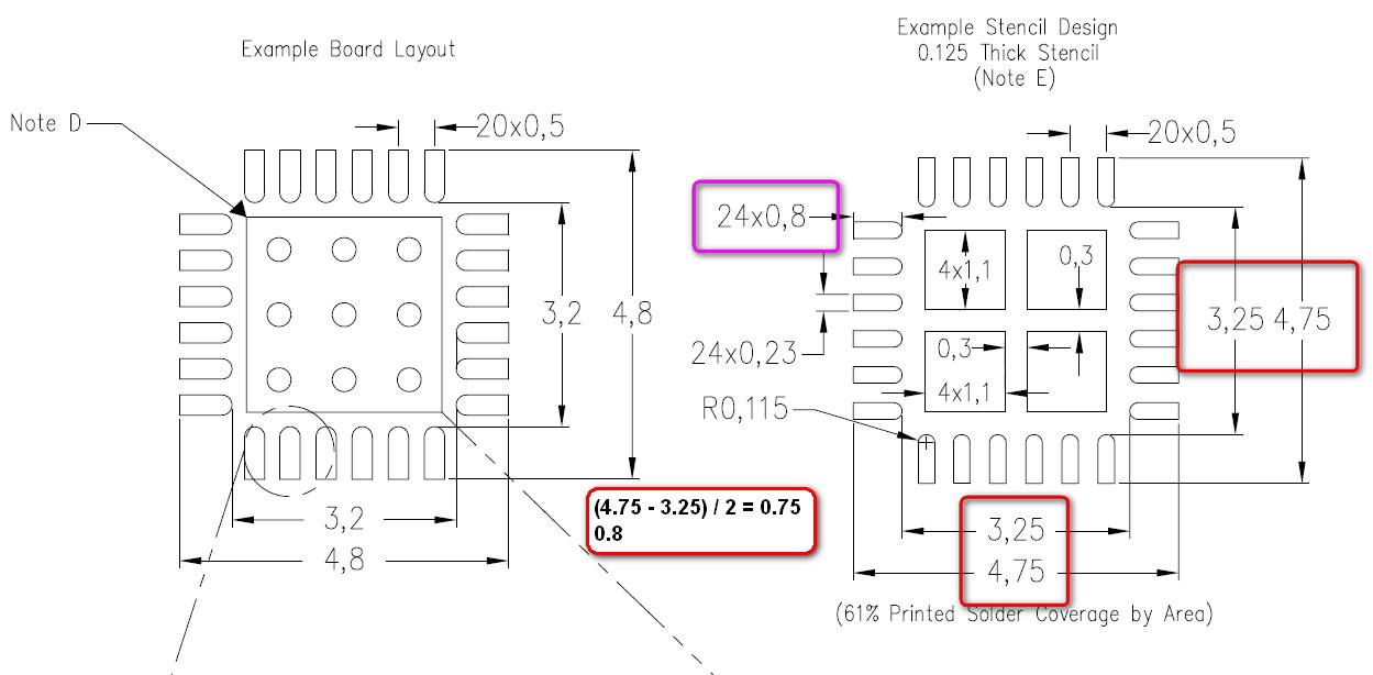

Hi There,
I have a question about the footprint of ADC3101 as below:
It seems the 2 diagram doesn't match each other. It seems the stencil design is wron or something. Could you kindly help to review this?
Thank you!
Dan Lu
