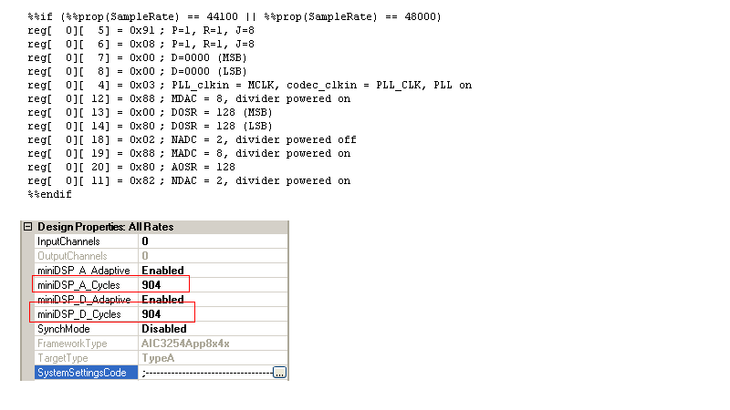

  • Hi Kato:
                  You can find the IADCand IDAC in PPS.
                   Click the franwork-->SystemSettingCode, in the souce code, you can find the IADC and IDAC's meaning.
          And you should type this value in the block of "IADC/IDAC" in PLL Calculator, if you will use MiniDSP.

  • Hi Kato:
                  The PPS will not change the PLL divider. It just download the default one in script.
                   You can see the picture below:
         The red block is the miniDSP download's IADC and IDAC. The value you should write in PLL calculate.
           The maximum cycle is 50MHz/sample rate. If you sample rate is 48KHz, the maxium cycle is about 1024.
             The lower cycle means lower power. If your process flow is using a little cycle, you can decrease the value.
