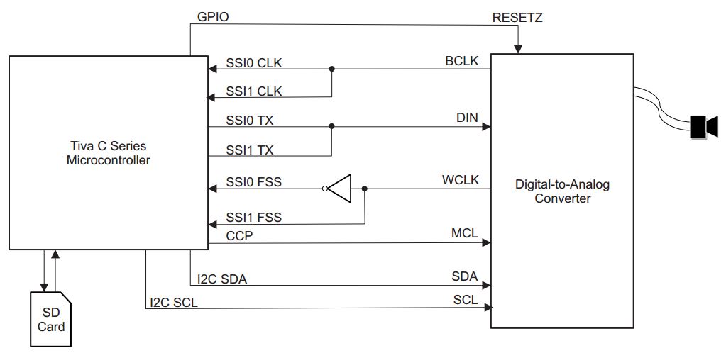

  • Hi Converter Apps,
    I want to use the I2S to send data from the AIC3104 (ADC) to µC and then from µC to AIC3104 (DAC). In the picture below you can see how to send from µC to AIC3104. How do I have to connect the Pins, if I want to send data from AIC3104 to µC?
    Sadullah
  • Hi, Sadullah,
    The TLV320AIC3104 has a DOUT pin used to stream the digital data from the ADC to the microcontroller. The I²S bus would be the same for DOUT and DIN pins. Please refer to below basic diagram as reference.
      -Diego Meléndez López
