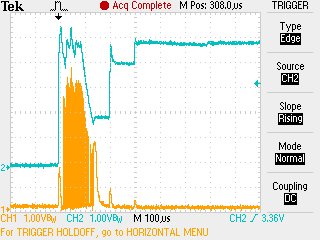

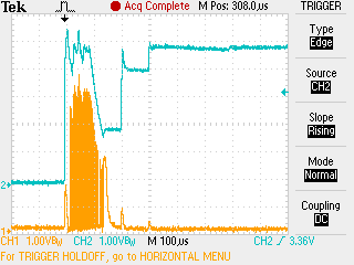

  • Further work has shown this problem is due to power supply ramp up problem.
    With a microswitch in series with the dc output of the PSU, the unit fails to start up, possibly due to switch bounce. The scope plot shows that the dc collapses shortly after power up, then recovers, but the device has not started.
    When switching on the supply at the mains, the supply ramps up more gently and the device almost always starts correctly. When touching the red supply lead on to the psu terminal, the device nearly always starts.
    It has a 4.7u tant across the rails on the IC. Removing this cap makes very little difference to anything.
    Once with the microswitch, the device drew 3 Amps and destroyed itself, perhaps both fets came on together, a kind of stall condition?
    Question is what to do now. The unit is powered from a wallplug supply, I cant guarantee how the dc connector of this is plugged into my unit, it might behave as the bouncy switch. Certainly cant risk the device destroying itself.
    Blue is the dc supply, yellow is one side of speaker WRT to gnd.
    Julian Worskett
