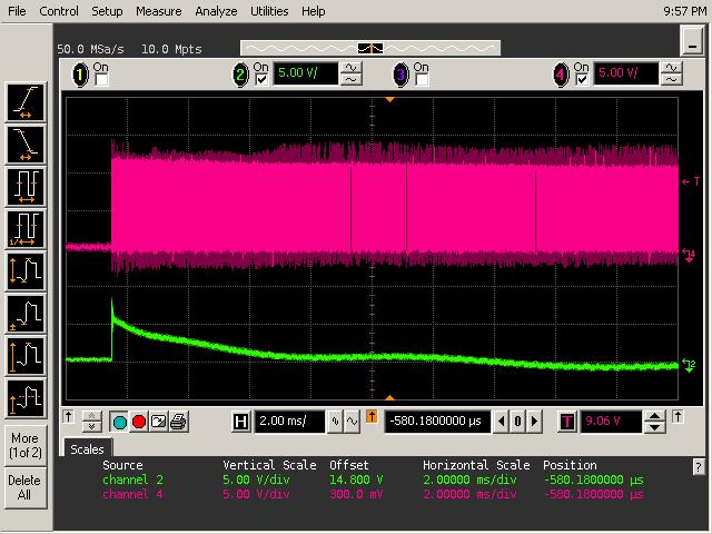

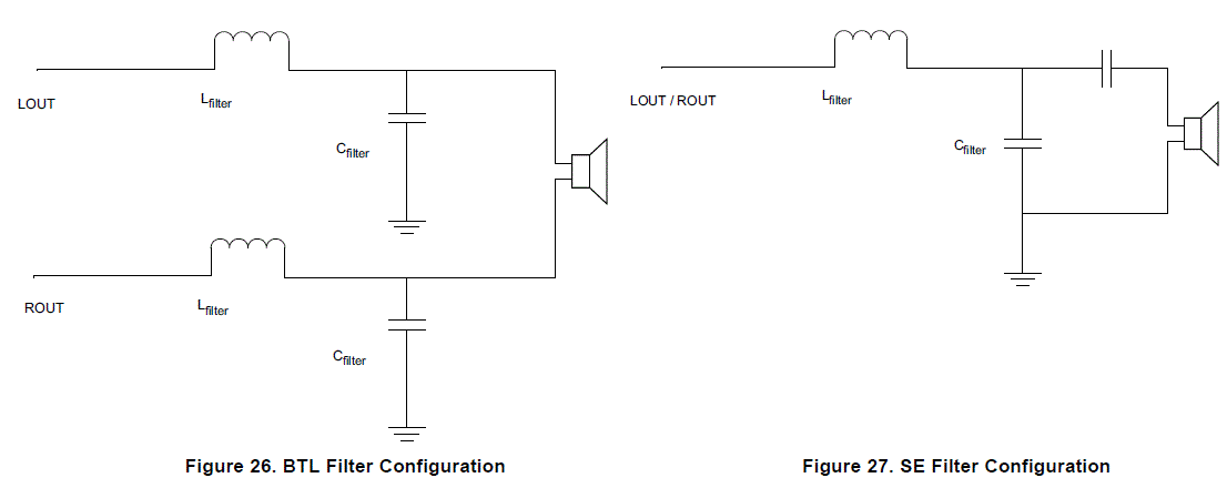

    I went back to do some testing on our EVM and actually found the pop sound as well! With Vcc about 15V or so there is an audible pop. So that's good, we're on the same page. In our case, this pop noise really comes down to the way the single ended filter works. Upon power up, the output DC level rises from zero torwards Vcc/2 (the DC of the 50% duty cycle PWM at at no input) fast enough that it passes through the DC blocking cap right before the speakers. In my case this would be a sudden 7 or 8V spike hitting the speakers which produces the pop. I have captured some scope shots to show this farther below.
    The first scope shot shows a zoom out of the PWM of the TPA3122 output (pink) and the point right between the DC blocking cap and the speaker (green). you see that at start up the sharp rise of DC level at the speaker which is from TPA3122 output DC flowing right through the DC blocking cap and then goes back to zero (what we expect normally with the blocking cap blocking the DC). The second shot is just a zoom in to see the rise due to the sudden change in DC.
    As you see from the comparison between BTL and SE, there is no DC blocking cap in BTL, since the differential outputs are on the same DC level. It is because BTL doesnt need this DC blocking cap, that BTL doesn't have the pop noise issue like in SE. Try it on your set up and see. I would suggest you to work with BTL, if you can that would great and you wont have the pop anymore.
     If you are sticking with SE, then we can try some solutions for de-pop. A common one is to bias the other end of the speaker (where the ground is) with a Vcc/2 voltage. As you can picture, when the DC rises suddenly towards Vcc/2 in our scenario, the DC accross the speaker witll now be negligible and thus suppressing the pop.

  • I took out the series cap and attached a speaker as BTL (with no signal on the non-BTL input connection), power it up, and instead of the massive pop, got just the faintest soft tap sound, just like the scope shot above suggests. So that works nicely.
