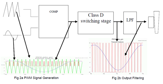

Not requiring a center-tapped power supply is a great feature of the TPA3122D2 and related devices.
But if the VCC/2 supply voltage is available anyway (e.g. a -12/0/12V supply), then, since the speaker output voltage is centered around VCC/2 (and in fact "rests", via 50% duty cycle, at VCC/2 when Mute):
Would it be helpful to use it as the ground for single-ended speakers, such that the voltage they see varies from (e.g.) -12 to +12? Or do the external filter Rs and Ls already correct the output voltage from 0to24V to -12to+12V at the speakers?
thanks.

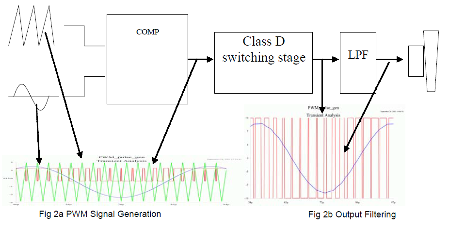

  • Hi Achoox4,
    Yes, the external LC filter centers the 0 - 24V PWM signal at ground. With a 50% duty cycle signal, the DC average is constant at the center of the swing, thus you can say signal rests at the ground level. The output signal would follow this DC average, so the higher the duty cycle the higher the output goes above the ground, and vice versa for lower duty cycle (like diagram below - output filtering). In a sense, the output is like a virtual ground where the rails are centered, but is ultimately not the real ground. Please let me know if I understood you correctly and if you have any other thoughts. Thank!
    Brian Wang
  • Yes, that exactly answers my question - so there is no benefit to using a center ground on the speakers, and with the 0V ground, there is (nearly) 0 potential across the speaker when the input level (at the input cap) is stable at 0V.
