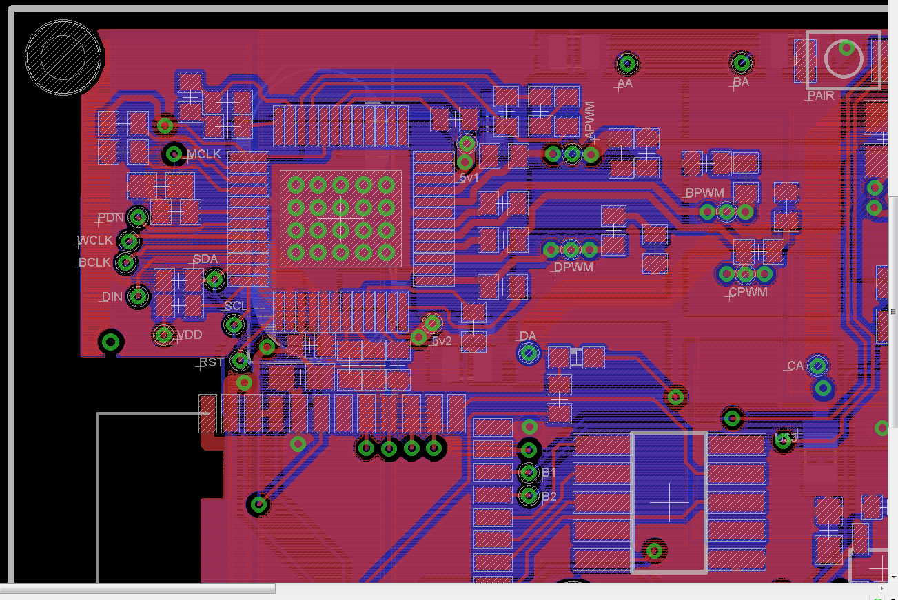

I've wired up a circut containing a 5717 to the mc57xxPISA that came with my tas5717 evk. I can connect over i2c and register 0x00 reads as 0x6c.
I set the ch1 vol 1 and 2 to 1.0 and set the master volume to max using the tas57xx GUI and then unchecked shutdown and mute. On the board provided with the EVK this resulted in audio coming out of the attached speakers. When I tried this on my circuit i got no audio.
The Error register 0x02 is zero. However when i read 0x01 i get 0xc1 (Datasheet says it should be all zeroes)
Is there anything I'm missing. anything else I should check?

    I've purchased the Tas5717evm and designed my own board based off of the evk. I' neglected to tie the supply and ground pins for the headphone amp to the rails but i wired those connections in with 31 gauge wire.
                 What do you means about the no audio? Output is nothing? or 50% duty cycle PW
    for each amp pair one channel was high and the other was low. they where not changing.
                 1. Check whether the power is OK.
    Rails look fine. i'm using 5v for my pvcc.
                 2. Check whether I2S signal go into the TAS5717(Clock and Data)
    MCLK, BCLK, WCLK and SDIN are going into their respective pins.

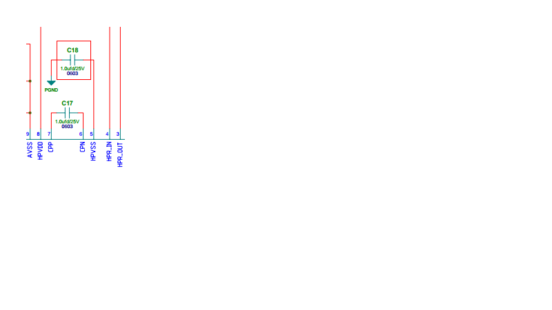

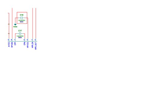

  • Hi Alex:
             The HPVSS pin should connect to GNd through the cap. See the picture below. If you connect the HPVSS to the GND, it will cause short charge pump short to the GND. This is why you start then SD again.

  • I've added the cap between hpvss and gnd. Lifted the pin and bodged in a 1uf 0201.
    After making this change and attempting to power up the amps (power on, connect via MC57, disable shutdown) i got the following waveform. I attempted to remove the 0.33uf caps to ground after each of the 4 inductors but the waveform on output D didn't change.
    I checked my component values and found the following errors. GVDD_OUT was 0.1uf not 1uf. the cap between cpp and cpn was 0.1uf not 1uf. and the caps to ground  connected through an 18 ohm resistor to out a,b,c and d where 33p not 330p (c25, c26,c34, c33 in my schematic).
    I've replaced everything but the 4 33pf caps and went through the procedure again and got the following waveform on output D.
    would 33pf instead of 330pf me enough to cause the outputs to be unstable? I don't have 330p on hand but I might be able to get 3 100pf caps in paralel.

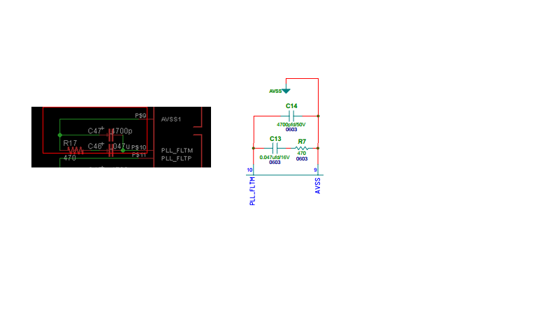

  • Hi Alex:
                You should modify the schematic at the pin9. You should connect the pin to the GND.
                 Please the picture below:
  • Edit made.
