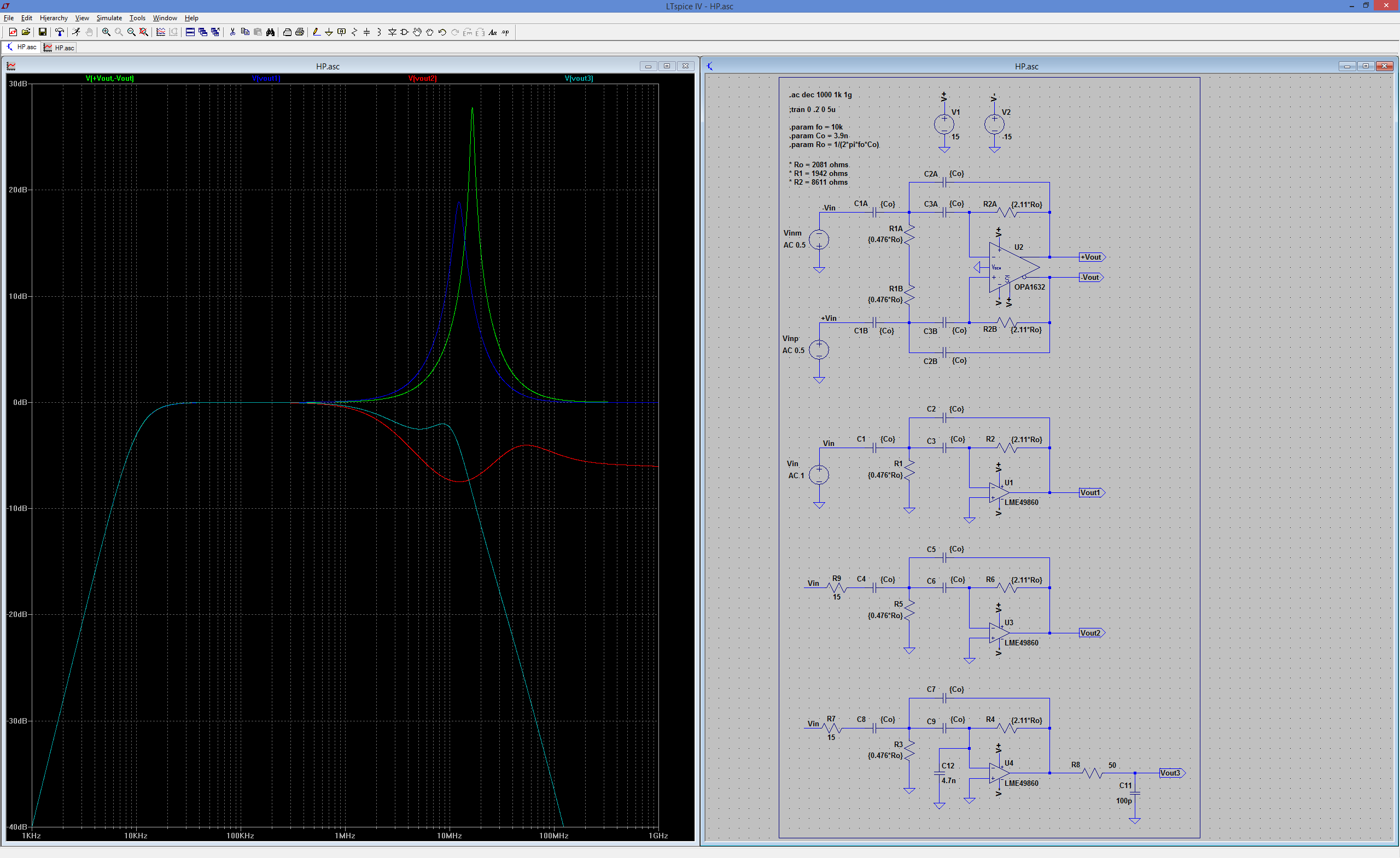

  • Steve & Don,
    Also found a problem with fully differential filters, both in this application note and FilterPro. In all configuration of a HighPass diff. filter, there are a ~ +30-40dB pole in the MHz region. (My simulations using 1 stage / 2 order).
    In all of my configurations - before and after this HighPass filter -, 1MHz is clear, straight and definetly needed. Any advise about how to solve this problem without using other filters / stage.
  • Thomas,
    I was able to duplicate your resonance problem with the fully differential high pass filter, and then I duplicated it using a single ended filter because it's easier to analyze.  It looks like it's a problem with filter topology caused by the non-ideal performance of the op-amps, but I don't know exactly what.
    SLOA049A describes the non-ideal performance of  Sallen-Key and MFB low pass filters, so I tried adding an RC filter to the output of the amplifier as shown in SLOA049A.  That helped, but not enough.  I then found that adding a small resistor in series with the input damped out the resonance very well, while the RC filter on the output rolls off the response at higher frequencies.
    This was all using ideal capacitors, once you put in the actual ESL and ESR values it could get worse.
    Steve
  • Hi Steve,
    Thank you for your answer, i also made these simulations in LTSpice and had the same results and conclusions.
    Thanks again.
    Thomas
