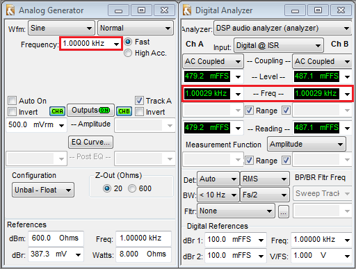

    I am Using Audio Precision APx585 Audio Analyzer to give the Analog Stereo Input Data to the EVM Board and collecting the S/PDIF Signal in my Analyzer.I am giving the Analog Signal of 0dbu as an input to the EVM Board and Collecting the o/p S/PDIF Signal in the Digital Analyzer  .The Analyzer is Locking on 44.1 Khz Sampling Rate,but it is not showing any incoming data.Please help me out in overcoming this issue.
    If you want any further Clarification about the issue then feel free to write it to me.

  • Hello Jack,
                         I tried to check and analyze the digital output with increased ANALOG input level upto 7V.But still I am not getting any data on my analyzer .The Analyzer is still locking on 44.1 KHz.
    No,I have not removed W9 jumper from EVM Board.If it is Required to remove W9 jumper in order to make the test ?
    One more thing I did is I tried to run the ADC by selecting the XTI as ADC Clock source.I made the value of 42h as 0x02 ,value of 60h as 0x22 and rest all register's values same as what U sent .So at that time I was expecting the Analyzer to lock on 48KHz but it is still locking on 44.1 KHz only.
    Please Clarify me this situation as I want to use XTI as the clock source to the ADC.
    Also please assist me that how may I be able to have data in the Digital Signal coming out from MPO 0/1 .
    Thanks and Regards,
    CB Vats
  • Hello Jack,
                         Now I am able to perform the ADC Operation with the help of EVM Board. I am getting data in my analyzer and also I am able to vary the Sampling rate According to my choice and the Analyzer is Locking on the same Sampling Rate.I am using XTI as my ADC Clock Source. Thanks a lot for your support.

  • Hi Sonu,
    I don't think this is related to the register settings, I have test it using AP SYS-2722, the frequency is very accurate with our EVM board. See below results:
    Have you followed the schematic I drawn to you? Do you have any filters on the ADC input channels? Have you measured the frequency on ADC input pins?
    Thanks.
