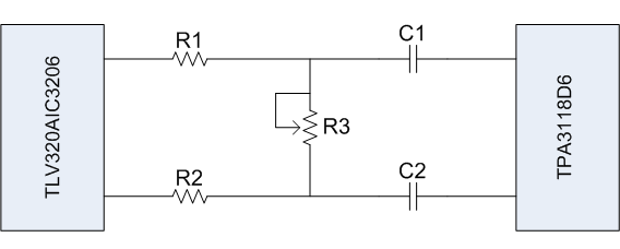

I'm working on a design with the TLV320AIC3206 Audio Codec, this codec will drive a TI Class D TPA3118D2 audio amplifier. While I know that the codec has support for a digital volume control I'd like to add the possibility of using an "old fashioned" potentiometer based analog volume control since the system initially will lack software support for the digital version. The plan is to use the differential interface between TLV320 (output on [RIGHT,LEFT]_LOP and _LOM) and the TPA3118 and to add an optional shunt potentiometer for volume control. My question is regarding the output impedance of the TLV, and also the input impedance of TPA3118, this information is not clear to me from the datasheets. On the output side there is a specification of differential swing into a 10k load in the datasheet, but that doesn't really tell me the output impedance (?). Should the 10k load be intepreted as a single ended or differential load impedance? Same question applies to the TPA3118, is the input impedance shown in table 2 of the datasheet single ended or differential impedance? I assume single ended impedance, is that correct?
Attached is a small sketch of the proposed connection, my headache is to determine the values of the R1-R3 and C1-C2. I assume R1 and R2 are needed to protect the TLV against shortcircuit on "0 volume" setting. DC blocking caps should as far as I can tell also be required, although figure 13 of the TLV datasheet shows a similar application without them (?).
Any input appreciated!

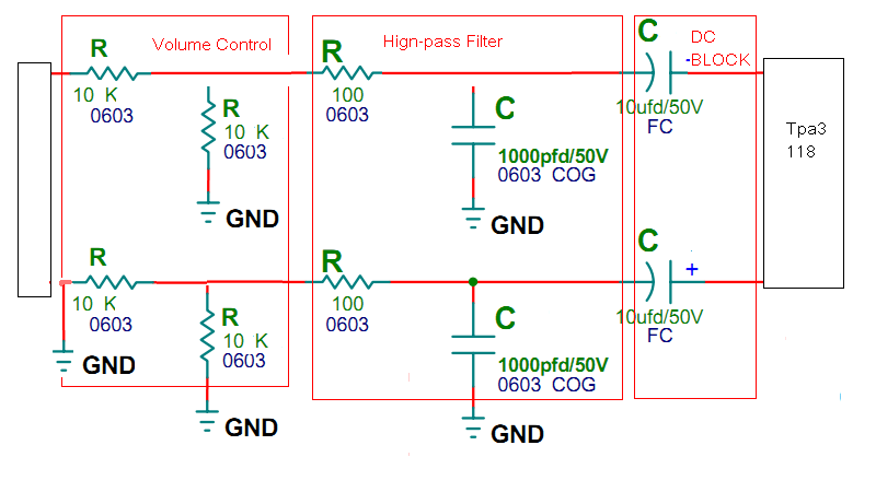

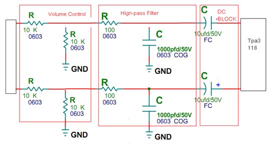

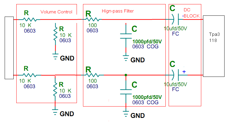

  • Hi
    In fact , we usually use the circuit like below:
    The first block is used to volume control through change the resister R(the one connect to the ground).
    The second block is used to filter the high frequency noise.
    The third one is the DC block
    Thanks for the input. Is that example circuit above per channel (i.e. differential input mode) or is the example shown for a single ended input configuration?
    Daniel
  • Hi
               This is for Tpa3118 differential input.

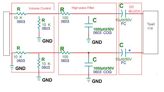

                If you want to use single ended input configuration, see the picture below:
                Cut off one input from the AIC3254 and connect to the GND.
