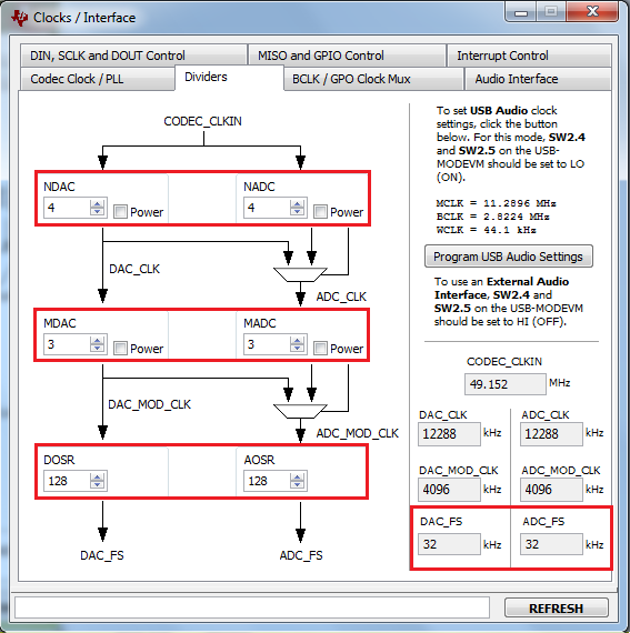

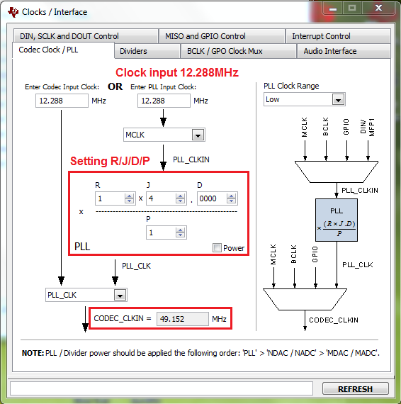

  • Hi Albert,
    Changing the sample rate, you can just change below parameters:
    Here it is assumed that the Master Clock input for AIC3204 is 12.288MHz, using PLL as the Clock_IN for Codec.
    BTW:
    It is better that you can provide your configuration scripts or code for AIC3204 Clocks.
    Thanks!

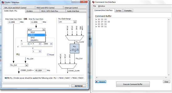

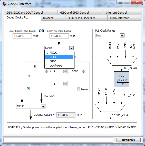

  • Hi Albert,
    It is easy to configure this with our EVM GUI software, you can download it from AIC3204 EVM page, changing the PLL clock source to BCLK.
    The link is here: http://www.ti.com/tool/tlv320aic3204evm-k
    Thanks!
  • I have already downloaded it. However, as I said I don't know how it works. It doesn't detect my board TMS320C5515 EVM.
