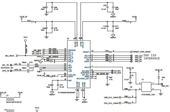

 im using aic3204 on a ezDSP C5515  based design board,in the event of trying to capture audio from the codec and feeding that pcm data to speex open source codec
i doubt the codec configurations done i use a electret (2 wired ) micro phone usually it requires mic bias and im using to LDO for that purpose  my configuration code as follows

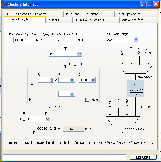

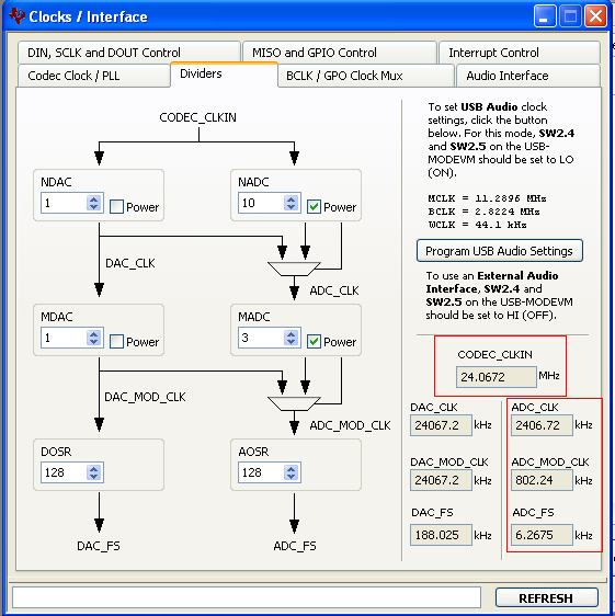

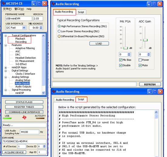

  • Hi Shyam:
         There are some problems in your setting:
         1.You don't power on the PLL power. So the PLL will not output anything.
         2.CODEC_CLKIN = PLL CLK=30720000 but your configuration is not that value.
  • Please see the picture below:

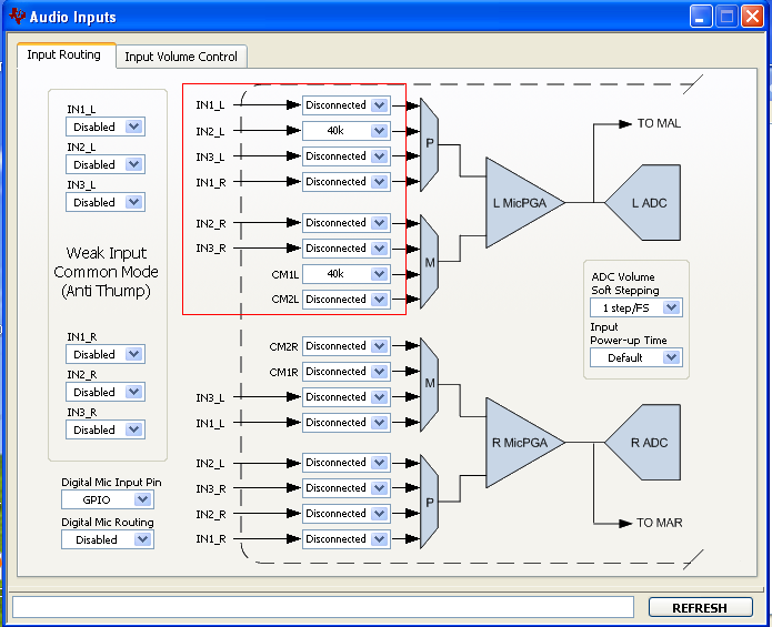

  • Hi Shaym:
              1. What's your input? Mic or Line in? If it's Mic, how do you connect the MIC and the MIC is the IN2L input?
              2. Check whether the clock is right, including the MCLK, WCLK, BCLK. You can also check whether it has Dout output.
              3. If you want to Analog in and analog output, you should configure the page 0, register 0x1D to 0x10.
              And you mute the ADC.... The MIC or the Line in from the IN2_L?Single ended?
    If you don't have the EVM. You will not get the data from the software..

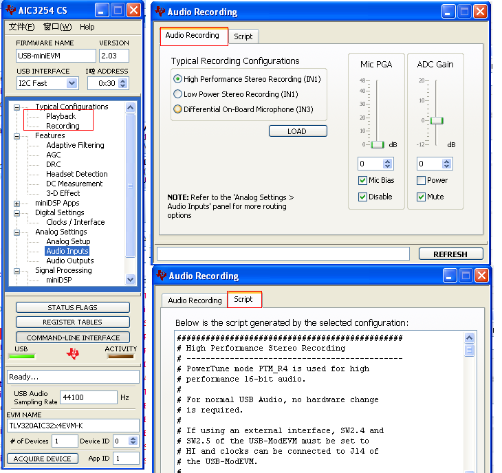

  • Hi Shaym:
                    If you want to fast setting the AIC3204, you can use the picture below:
               You can get the code from the script. And the hardware connection should be like the EVM.

         Q     1. What's your input? Mic or Line in? If it's Mic, how do you connect the MIC and the MIC is the IN2L input?
         A.      my input is through AIC line 2L,so mic in goes to left channel ?

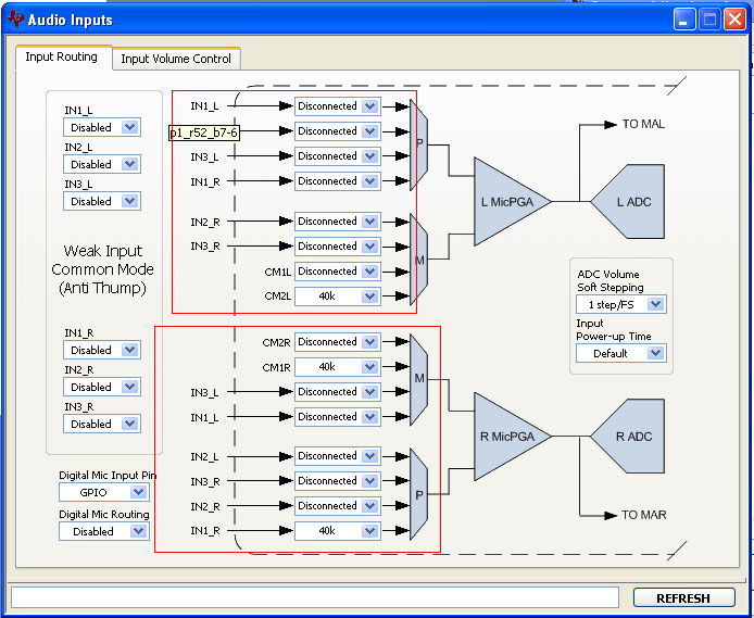

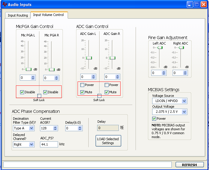

  • Hi Shyam:
                     1. I suggest you use the PGA, because usually the MIC's input is very small.
                     2.  If you mute the ADC, you will not hear the voice at the output.
                     Can the codec work normally now?

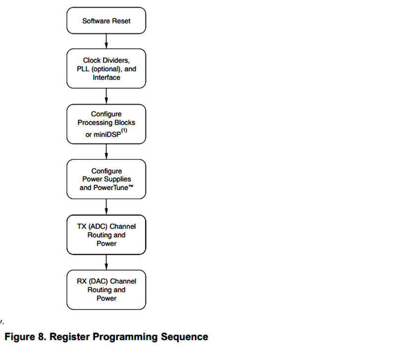

    my programs flow

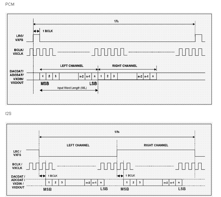

    1.Take pcm data from aic3204(what diff it will be if i config as master or slave ?)
    2.read the data through i2s interface as shown in ezDSp c5515
    3.send that 16bit sample to the codec( iam using speex)
    4.get the compressed data and send it through UART
    targets 2,3,4 are any ways coded well and checked
     thing remained is achievement 1 .....now i want to start it very clear the configuration manual clearly says

    i have choose to listen the audio from right left and my mic in also comes from line 2 left so i have unmuted left and muted right

  • Hi Shyam:
             For initialization, You can refer to the attached file.

             is at  the page 0, but you configure at the page 1...
             Be careful the page which you configure....
             Check the MIC connection. You can refer to our EVM, because I can't see your MIC connection in your schematic, or you can use the line in instead to check.
    If you want to configure ADC to DAC, you should configure :
    Digital loop, which put the ADC's data to DAC. Or the ADC's data will not send to DAC side.
    w 30 00 00
    w 30 1D 20
    You can test the Dout at the AIC3204 to see whether have data output, to make sure the chip work.

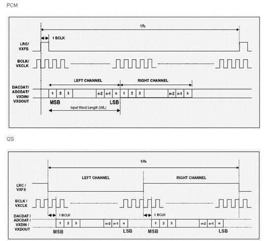

    This is what wasted my 2 days time,but one more problem has arise the data which is coming from left channel should go in to LSW or MSW ? in my case i am seeing it in MSW is that right?
           more over my speech codec engine speex expects a signed value of PCM but AIC gives us 2s complement value how to manage with it,as now speex has become absolute there is no one to comment on it any TI engineer has worked with speex could help me ? how could i approach ?
  • Hi
          What do you mean about the LSW and MSW? Is the MSB and LSB?
          Because the audio interface is I2S format, actually the I2S is also PCM signal which has some offset in some mode. I think you can try to use DSP mode.
          Receive the data and do some shifting at the data, you will get the data you want.

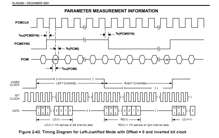

  • yeah i am seeing the data in MSB is that desired ?
    and DSP format and i2s doesnt make any difference can you please refer any TI engineer who worked on speech codecs if possible at least on any codec
  • Hi
           Right,  MSB is first.
    In fact, I2S data and PCM data are similar. If you can set a counter to get the data which you want.
    BCLK like the PCM clock, the WCLK like the syc clock.
    And TI also has PCM Codec. Like TLV320AIC3110.
  • A "signed value" typically means twos complement and that is what the AIC3204 will provide. i.e. the AIC3204 will provide you with an Int16, most significant bit first, across I2S.
