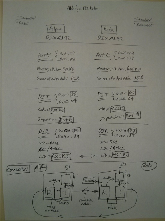

I have two questions regarding the configuration of DIX4192.
First questions is related to register 15 (Receiver Status Register 3) and 'OSLIP Error'. I use Port A to output DIR data in "Master Mode" with RXCLKO as clock source (Register 3: 0x29, and register 4: 0x08), I do not use Port B (but I set register 5: 0x41 to mute Port B, and register 6: 0x0). Now, if I enable OSLIP interrupt in register 17 (= 0x01) and read the status from it (register 0x15) I got an OSLIP error indicated all the time. My receiver part works, but I am a little bit confused as I understand the description in register 15 that this error occurs only if I use a slave configuration of the Port A or B for output DIR. Do I miss something?
Second one is regarding the 'Receiver Loss of Lock' (LOL) option in register 0x0E. In my application I have a receiver which will locked to transmitter (also DIX4192) and play audio (192kHz), it might happen that somebody removes the cable totally so that I will lose lock. If user plugs calbe in again it should work as before very quick. In most cases that works very well with activated "LOL" option (my configuration of register 0x0E in that case is: 0x19), but sometimes it will result in toggling nLock on receiver. I measured already RXCLKO which looks good, but that state of toggling nLock (which you can, of course, hear also in audio) will not go to an stable state even after a relly long time. If I do not use the "LOL" option it looks good for me, but it takes more time to activate audio again after loss of lock.

  • Hi Arnold Zhang,
    regarding item #1): We are using CAT-5 twisted-pair cable, I do not understand what you mean with "it is in I2S". With incoming cable I mean the cable from the AES/EBU transmitter (also a DIX4192) device to my AES/EBU receiver (DIX4192).
    To point #2), no in that case I meant the 'nLock Pin' of the device. Regarding the co-dependence of biphase error to my unlock problem, it could be that this is the cause, but I also remember that sometimes I couldn't see a biphase error but had same problems. How will the error status register bits reset? Only on read?  Or also if the error disappears?
    To your last questions, we really would like to use the option as it is very fast in reconnection, but if that may cause sometimes problems we won't use it (and if you recommend to not use it as we do it, we won't do it either ;)). Last but not least, yes if I unplug/re-plug again the cable a few times, it may result in stable system again.
    Here is the configuration I am using:

  • Hello Max,
    Some questions up front regarding your set-up, please clarify for me:
    Transmitter DIX4192
    : I'm not understanding your set-up here. Are you getting audio from DIR, and sending that through to both Port A and DIT?
    Also, you are using Port A as source for DIT? Is SDINA connected to a source? But your master clock is coming from the DIR's RXCKO?
    From your config:      {0x07,0x86},                       // (byte 5) TX Con 1:    AES/EBU TX use PortA, WCLK = clk/128 = 192kHz (@24.576MHz), clk = RXCLKO, valid bit = true
    Receiver DIX4192: For this one, you are getting audio from DIR. Are you sending this to just Port A?
    Also, your last configuration notes say that you're using Port B, when everything is else points to Port A... please explain for me! And wouldn't this use RXCKO as receiver?  (Is the DIT being used? Is Port B being used?)
    From your config:      {0x07,0x0E},                        // (byte 5) TX Con 1:    AES/EBU TX use PortB, WCLK = clk/128 = 192kHz (@24.576MHz), clk = MCLK, valid bit = true
    ( Are these two simply backwards? )
    I am getting confused by your register 0x0E settings for both (see below as copied; you have two for the transmitter). I'm going to assume you have register 0x0E set to 0x19 for both, so that your RXCKO output is enabled, and PLL is set to keep running but with output muted on loss of lock.
    Transmitter:
    {0x0E,0x19}                      // (byte 8) RX Con 2:    RXCKO output disabled, clk divider = 1, auto mute enabled, pll runs free if lose of sync
    {0x0E,0x18},                     // (byte 10) RX Con 2:    RXCKO output disabled, clk divider = 1, auto mute enabled, pll runs not free if lose of sync
    Receiver:
    Did you not configure DIR PLL1 in the receiver DIX4192, or can I assume you set to 192 kHz did for both?
    Is the OSLIP error happening on both DIX4192 or just your receiver?
    For the error status registers: since I'm getting a different read the first time after an "event" (such as removing the cable into the receiver), but a different yet same read thereafter, I assume that these registers simply retain errors, and then refresh upon a read.
    For the OSLIP error, with regards to the receiving DIX4192, I am also always getting an OSLIP error. Since the audio seems to be fine, and you're in master mode for Port A, this does not appear to be essential.
    For the Receiver, when you are getting toggling nLOCK pin. I'm using a coax for RX1, and I'm also not using another DIX4192 as transmitter, but a different tool (we don't have 2 DIX4192).  When I unplug the cable, I will lose the lock, though the errors go away after a read.  After I reconnect, I have always gotten working output at Port A, and the errors also go away after a read.
    At any rate, unplugging and replugging repeatedly may be the best intermediate option, if nLOCK does continue to toggle.

  • Hi Arnold Zhang,
    first of all, thanks for the really great support with that topic!
    I am really sorry for some misunderstandings with my last post, I did some copy-paste errors.
    • Yes, both devices, transmitter and receiver, are configured to use 192kHz as PLL1 configuration (I simply missed to copy the section to receiver section)
    • Yes, your assumption is correct, both are configured to 'mute on Lock loss and leave PLL running' (the option with deactivated LOL was just for test purposes)
    • Regarding my configuration/setup: that is a little bit tricky, I have bi-directional connection from transmitter (base) to receiver (extended) device and backward, but my receiver device will use PLL generated clock from DIX (RXCLKO) in device as audio clock and send audio back to transmitter device. One possible configuration is also that I just route back the aes/ebu data through DIX to transmitter.
    • Also I did a copy mistake on receiver configuration, as you already mentioned correctly, I am not using PortB on Receiver, I am using Port A to output data.
    Ok, so I will ignore the OSLIP error in that case. As I had never really problems with audio too, I ignored it anyway and just asked to be sure that I didn't miss something.
    I am not sure that we talk about the same thing, of course I get a toggling signal (from low to high) on nLOCK pin if I remove cable, but that isn't the problem. With toggling I mean that if I reconnect (and leave reconnected, and therefore having an active aes/ebu stream)  cable, I get sometimes an unstable system which starts to toggle nLOCK signal shortly sometimes. If that happens it looks like as if DIX is not able to resync to aes/ebu stream, even if RXCLKO shows correct clock. As disscussed I can see sometimes in error register that there is a biphase error, which I assume shows that also that DIX is not able to resync PLL correctly on aes/ebu stream.
    Max

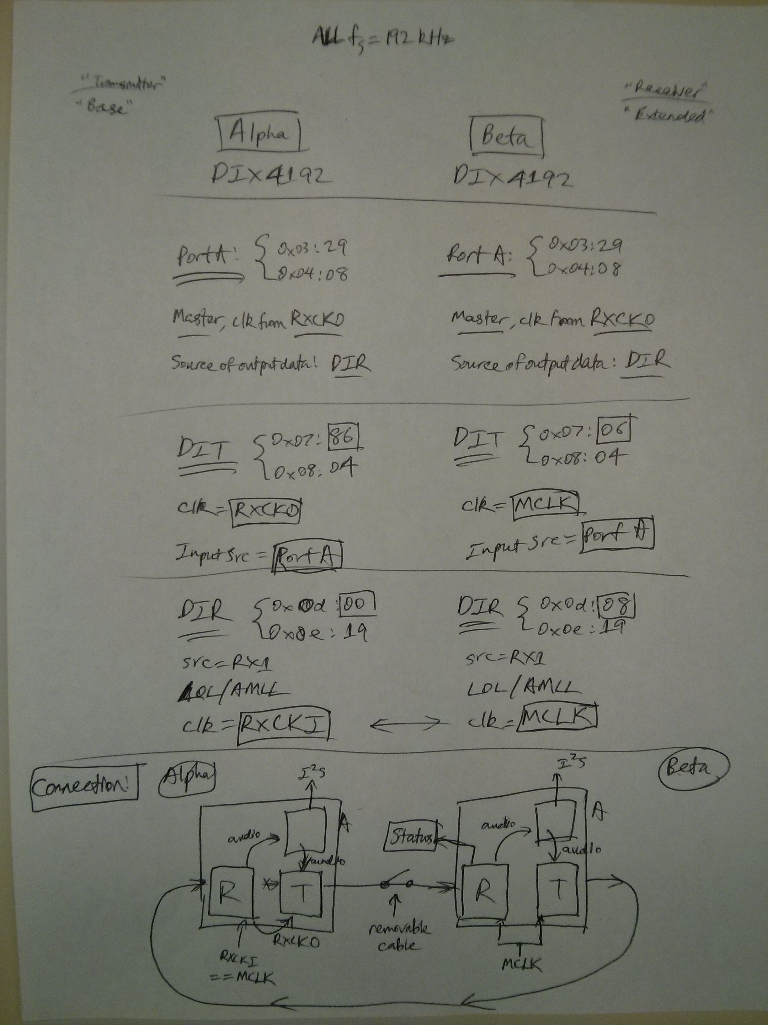

  • Hello Max,
    I'm not 100% on your set-up. But from your register configuration before, I will assume the following summary view:
    0x07 = 0x86,  0x0d = 0x00   -> "Alpha" DIX4192  (Base, Transmitter?)    -> DIT clocked by RXCKO
    and
    0x07 = 0x06, 0x0d = 0x08   ->  "Beta"  DIX4192   (Extended, Receiver?)  ->  DIT clocked by RXCKI (effectively MCLK)
    If I assume "Beta" is the one you're checking nLOCK on, then as I said before, after unhooking the incoming cable, and reconnecting it, the nLOCK stabilizes after a while (some brief flickering for 2 seconds max, at times?), and all register reads of 0x14 give 0x01, or no UNLOCK, Biphase or other errors. This is if I'm only using "Beta", again.
    In the case I assume "Alpha" is the one you're removing the incoming cable from, I also get the same results.
    Essentially I don't seem to be re-creating your error with my abridged set-up. Port A always measures fine. Is there noticeable flickering of the nLOCK light? Mine appears steady.
    Arnold
  • Hey Arnold,
    wow, it is really awesome how hard you work on this topic, thanks again for that!
    Your picture is corret, in our application we have just one cable between base and extended unit (alpha and beta device). Of course we have seperated lines for tx (alpha->beta) and rx (beta->alpha) connection, but they are within one cable, sorry for the missunderstanding. So we loss nLock on both devices shortly, but the nLock toggling will occur only (and just sometimes) on beta device (base backward-receiving) after reconnection (and only if I use LoL option).
    Max
  • Hello Max,
    Okay, thank you for confirming the picture set-up. (By "separated lines", I assume you mean twisted-pair balanced lines..)
    I'm not sure I'll be able to re-create your set-up, since I only have one DIX4192.  Again, what does the nLock toggling look and sound like..? Can you describe how often it toggles, for example?

  • Hello Max,
    It seems that it this locking issue is as you suspect, due to the configuration of data and clocking paths you have. The stable RXCKO on beta device might happen even with biphase errors... Perhaps without LoL and free-running PLL, the restart enables it to resync properly. In that case when you repeatedly unplug/replug you eventually get lucky with LoL on and it syncs properly.
    I'm not sure how your application works, so I have some more knuckleheaded questions. All I see is a giant loop of audio information... where does the audio data enter? My understanding of your application had information coming into each DIR, and going through and out of Port A, and also to the DIT (since my understanding is that the DIT pulls from Port A the same information sent over from the DIR..). Is one of the Port A's or Port B (maybe Beta / base device? whose DIR and DIT clock sources are both MCLK) set to be the entry of audio data? Is just SDIN coming from Port A on the base DIX4192?
    I don't have two DIX4192 so I can't experiment, but in my test having the DIT set to RXCKO makes the data cleaner if receiving from the DIR (but not from Port A...)... Maybe you can try adjusting the TXCLK and TXDIV[1:0] in register 0x07 to experiment...?
    Arnold Zhang
