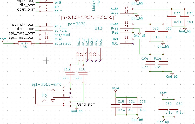

I am planning to implement the below circuit for audio mixing using PCM3070,
Inputs : HPL_A_1, HPL_A_2, HPL_B_1, HPL_B_2
Output : LOR ( pin 23 )
For this, I am trying to configure PCM3070 registers with MSP430 via SPI.
I would like to know what are the registers that are necessary for this application.
I know that its all available in the datasheet, but i would be nice if TI experts could  pin down the necessary registers for this application.
Would be useful for others too.

  • Winnefred,
    There are example configuration settings in this app note: http://www.ti.com/litv/pdf/slaa404c.
    Things to keep an eye for:
    1) An external MCLK is required if using the ADC and DAC converters. I see pin 1 disconnected in the schematic.
    2) Your setup does not use I2S to communicate to other chips. In such case, the BCLK and WCLK must be set as outputs (master mode) if using ADCs and DACs. See app note for an example script.
    3) You setup assumes use of internal ALDO and DLDO. See app note for an example script.
    J-

  • Hi Arbona,
    I would like to know the current consumption rating of PCM3070.
    It is not available in the datasheets.
    Also, could you recommend a voltage regulator for the PCM 3070 operation.
    First, I notice that pin 18 (REF) connection is incorrect. It should only be connected to a cap and not to VDD.
    From power supply perspective, worst case assume 50mA for DVDD LDO + 50mA for AVDD LDO running out of LDOIN supply. On top of that, if you plan to power HP amplifiers out of LDOIN pin directly, then worst case for this is ~250mA assuming 64mW per channel into 16-ohm loads and 50% efficiency of class-AB amps (conservative). So 250+100 = 350mA worst case off 3.3V. In reality, 250mA is typically ok.

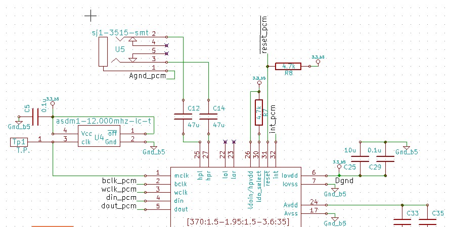

    I have proved your configuration (bypassing adc and dac trougth the pga and mixer amplifier), and it works well. Now I am trying to configure the pcm3070 to input a signal trought the adc and hear that signal from the headphones connected to the dac.
    I have seen the playback examples that appears in pages 67-69 of the slau332 document "pcm3070 Application Reference Guide",  and I have mixed it, I just added the loopback intruccion:
    30 00 00
    30 1d 10  // Stereo adc output is routed to stereo dac input
    But it doesn't work, maybe there is something missing in the configuration, Could you please tell me what is missing?, if neccesary here are the images form the schematic
    Daniel
  • Daniel,
    Is MCLK, BCLK, WCLK present?
    J-
  • The pin mclk (pin 1) is connected directly to a 12 Mhz oscillator‚ bclk and wclk are not present.
    Thanks‚
    Daniel
  • Daniel,
    For the processing engine to work, BCLK and WCLK must be present either externally or internally. For this case, you would then need to set BCLK and WCLK as outputs. This document describes how to accomplish this in the Appendix section (as sample scripts): http://www.ti.com/lit/pdf/slaa404.
    J-
  • Hi‚
    thank you‚ it works‚ I wasn't aware of that‚ and it was preatty easy to code.
    Daniel
