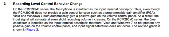

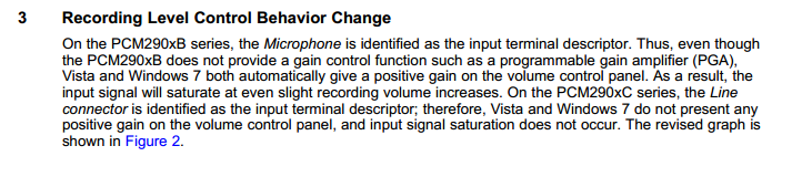

What's your part series? Usually the MIC's input is very small. And need PGA to increase the MIC voice.
You can find in this application note.http://www.ti.com/lit/an/sbfa020/sbfa020.pdf
