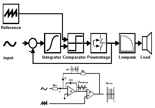

Im using the the amplifier TAS5611A with AD modulation.
1. I dont understand, how the feedback loop works.On the internet I found a picture, with the principle, but I dont  know if its right.
2. If I have an input signal, like sine - I get  an amplified sine wave signal on the output. But if I change the suplly voltage, the amplitude of the output signal is the same.
Why is it constant?
Thank you

    Think of it as the close loop architecture takes the output voltage feeds it back through some sensor mechanism to the reference (input). The feedback signal is compared with the reference and the difference (error) is then sent to the Powerstage. Because of this, you dont increase the output signal by increasing supply voltage, instead output signal increases with increasing input voltage. The benefit of this closed-loop architecture is a superior PSRR and subsequently better THD+N compared to open-loop amps. As you can see the noise coupled to the output from the power supply can be suppressed through negative feedback.
    This is a good article that discusses further the advantages of closed-loop amps: http://www.planetanalog.com/document.asp?doc_id=527759
    Please let me know if you have further questions. Thanks!
