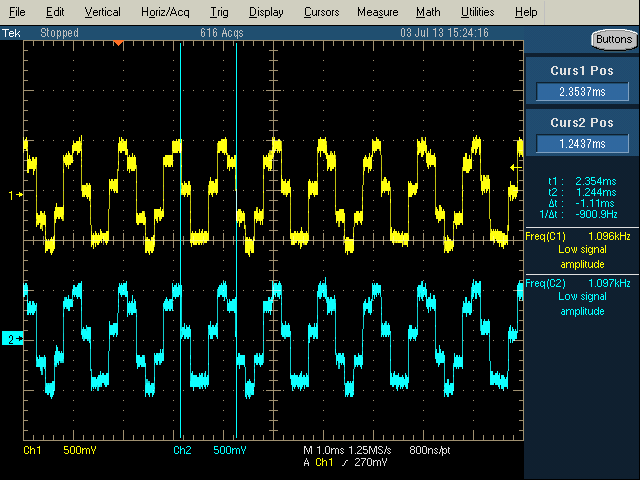

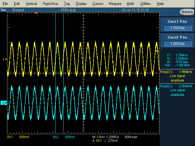

    I captured the waveforms of audio signal with each sampling frequency.
     - 44100Hz
     - 11025Hz
    For the sampling frequency of 11025Hz, the audio signal was approximately 1kHz audio signal even though I was set the 2kHz beep audio.

  • Hi J,
    Thank you for your response.
    I had a mistake in the MCLK value.  When I calculated the PLL settings, I had supposed the frequency of MCLK is 11.2896MHz.
    Actually, the MCLK was 5.6448MHz.  This is why the BEEP frequency was half value.
    Just in case, I attached the waveform as below.
    7024.TEK00009.TIF
    Please let me confirm the following question.
    Is this waveform correct as AIC32x4 operation?
    It seems that there are difference waveforms between 44.1kHz and 11.025kHz.
    Kaka
  • Kaka-san,
    Please set the DOSR value for 11.025kHz case such that DOSR = 128*(44.1/11.025) = 512.
    J-
  • Hi J,
    I confirmed the beep sound with your case. I attached it as below.
    Please check it again.
    2451.TEK00011.TIF
    It seems that it did not improve the beep sound with your case.
    Do you have any other ideas?
