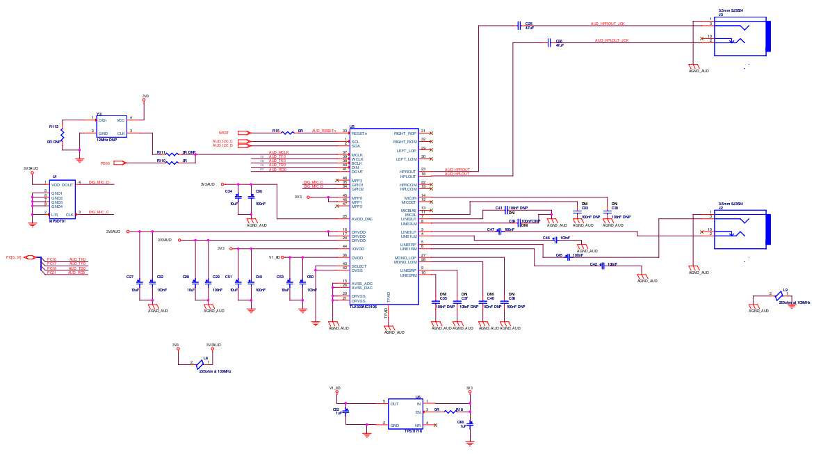

Hi experts,
    On working with TLV320AIC3106 Codec, i'm able to get the playback work which is checked using aplay command. But capture doesn't happen and I cannot see any signal on DOUT pin. Please look into the TLV320AIC3X register dump below and guide us where we are going wrong.

    It is not clear from this what inputs are connected in hardware, however, there are a couple of other problems. Neither ADC is turned on in Registers 19, and 22. Also the Right PGA is not unmuted in Register 16.

                 We would also like to give the following information , which will help you to debug the issue for us,
                 1. Line1LP and LIne1RP are alone available as inputs ( Hence, Line1RM, Line1LM, Line2LP, Line2RP, LIne2LM, Line2RM, MIc3R, Mic3L are all connected to GND).
                 2. MicBIAS is not connected
                 3. DVDD = 1.8V, AVDD_DAC = 3V, AVSS_ADC = GND, AVSS_DAC= GND,
                 4. MCLK = 12MHz, WCLK and BCLK are configured as inputs.
                 Also refer to the schematic for more information on the connected pins.
                From the above register dump, Left and Right ADC are powered on and unmuted.
                Please tell us the required TLV320AIC3106 register configurations that need to be done or any other changes required at the hardware level.
    Dhiv.
    In this latest dump, it looks like PLL values are sent but the PLL is off. Aside from that, I think it looks ok.

  • I would typically start by checking all of the clocks (MCLK, WCLK, BCLK), If those look ok, I would try an I2C sniffer to see what is actually being written to the registers and also the sequence that they are being written in (this insures that there isn't something wrong in the C code). If you can send the I2C log, we can have a look.
        On checking the signals by probing, we see the BCLK signal , but no WCLK  and DOUT signal on recording. Can the codec be configured to send the data based on the bit clock and data len per frame, since WCLK is not sent by the master for data transmission ? On playback which already works fine, we see WCLK, BCL and DIN signals. We will try to debug on this further and thank you so much for all time and effort you have taken in helping us so far.

  • How do you verify that the WCLK is sync'd to the CODEC? When the PLL is used to generate the clocking, it is best to have the CODEC as the master for WCLK since otherwise there is no easy way to insure that the sample rate determined by the PLL will EXACTLY match the external WCLK. This can lead to noise. there is an app note on the subject here:
    http://www.ti.com/lit/an/slaa469/slaa469.pdf
        Thanks for the insight. In our case, the Codec is receiving the BCLK and WCLK from the serial interface ( Synchronous Serial Controller), hence PLL is not generating the clock for us. Still we get the volume of the recorded voice very low and with noise. This is not the scenario with playback.
    Dhiv.
  • It looks like you are using the PLL? You are sending values to the PLL registers.
        Im sending values to the PLL registers. But the PLL is disabled, hence it is not generating the clocks. In our case, Synchronous Serial Controller (SSC) is the master and generates WCLK and BCLK for the codec.

    I saw that your MCLK was 12 MHz in the previous post however, I was hopping you had changed it since you were not using the PLL. If you are using the script above, then your sample rate is 12 MHz / 256 = 46.875 kHz. Your WCLK will have to be at exactly 46.875 kHz or you will have data errors. The sample rate is set by MCLK and the divider ratios (or PLL). The digital audio interface must exactly match this rate. This is detailed in the app note that I sent in a previous post.

    We figured out what was wrong, we found the codec in master mode is using slow clock , instead to use main clock, hence on changing the codec configuration to use main clock, our issue got solved
    Many more thanks to your team, that was a great support.
