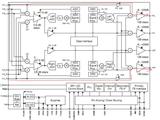

we have filters,amplifiers etc in AIC3204 but if i want to analyse the characteristics with respect to input how  could i by pass the ADC  and give it to analog out and check how they are working can any one please help
  • Hi DARAM:

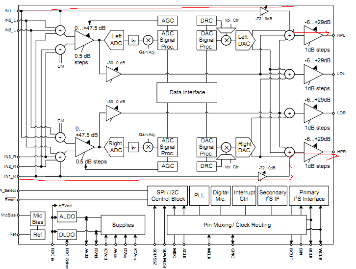

               Is this process flow which you want to use?
  • The Route you have shown above will just bypass the Filters and other stuff
