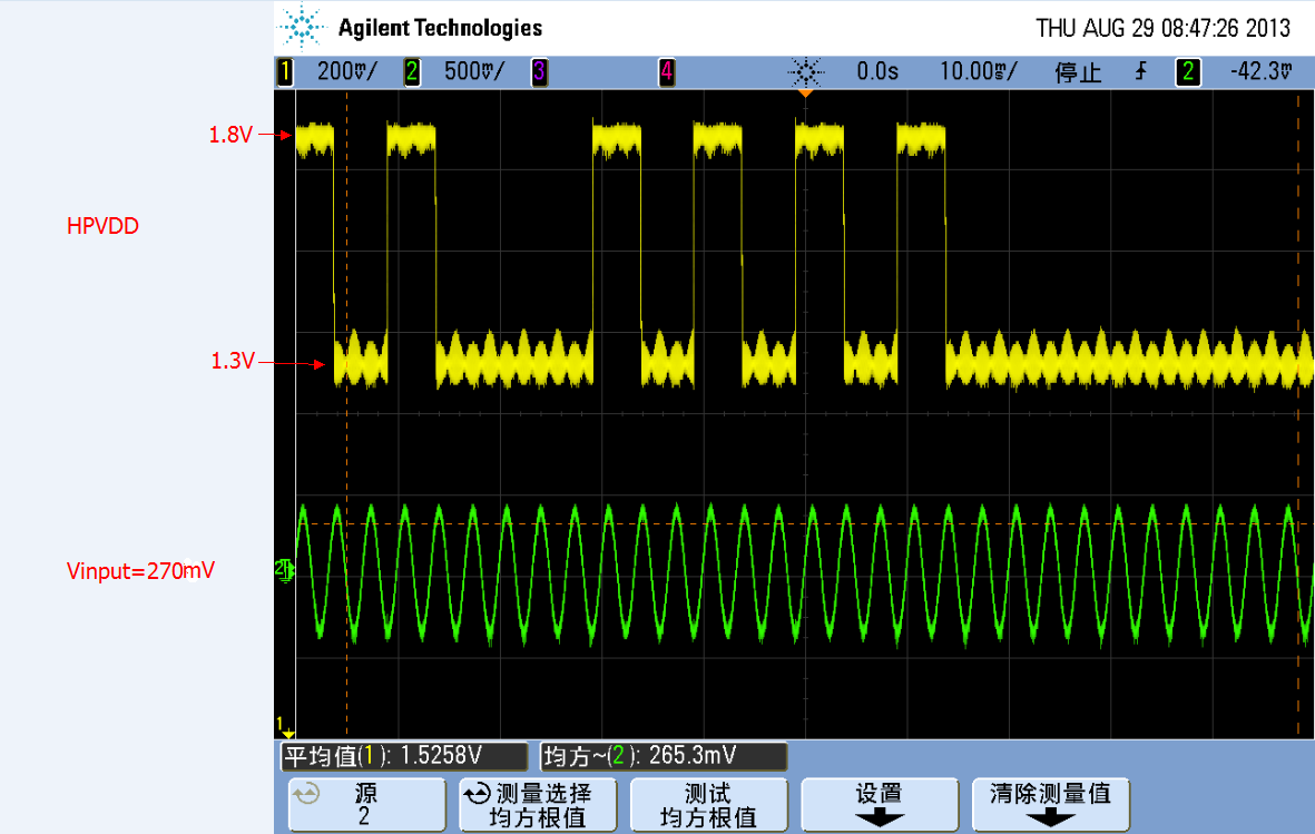

TPA6141 the HPVDD shake in power switch from 1.3V to 1.8V
Dear Sir

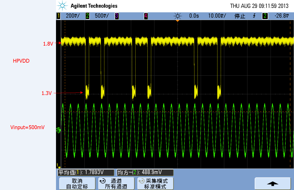

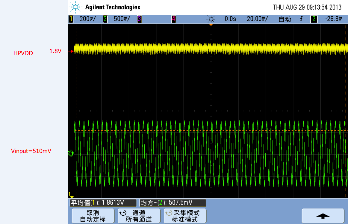

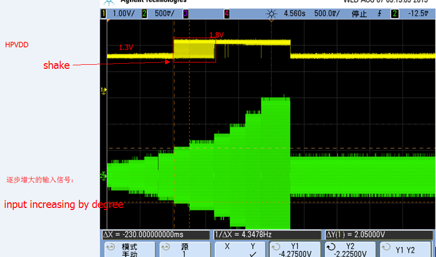

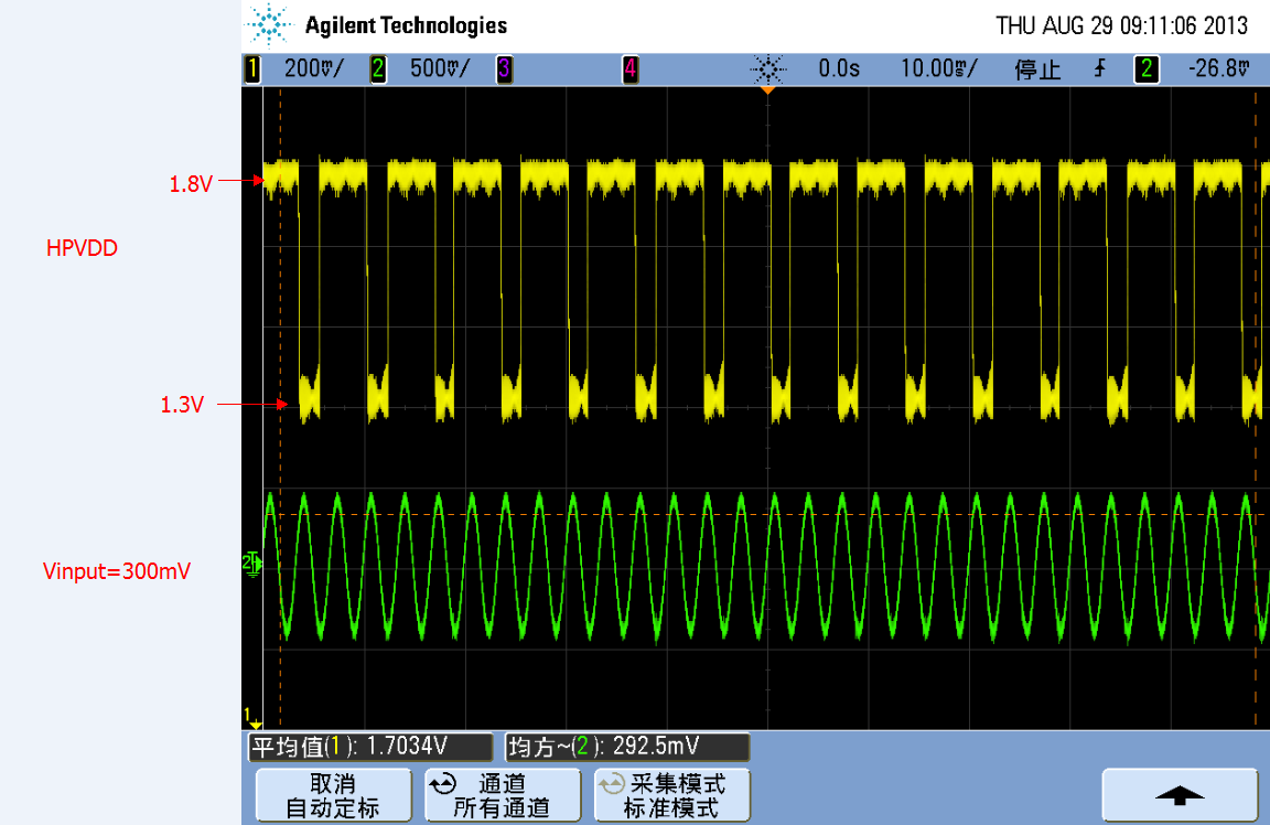

When I test the EVM of TPA6141,set the input signal ampulitude increasing by degree, the HPVDD would change from 1.3V to 1.8V, then find some shake happened. the waveform is as below,

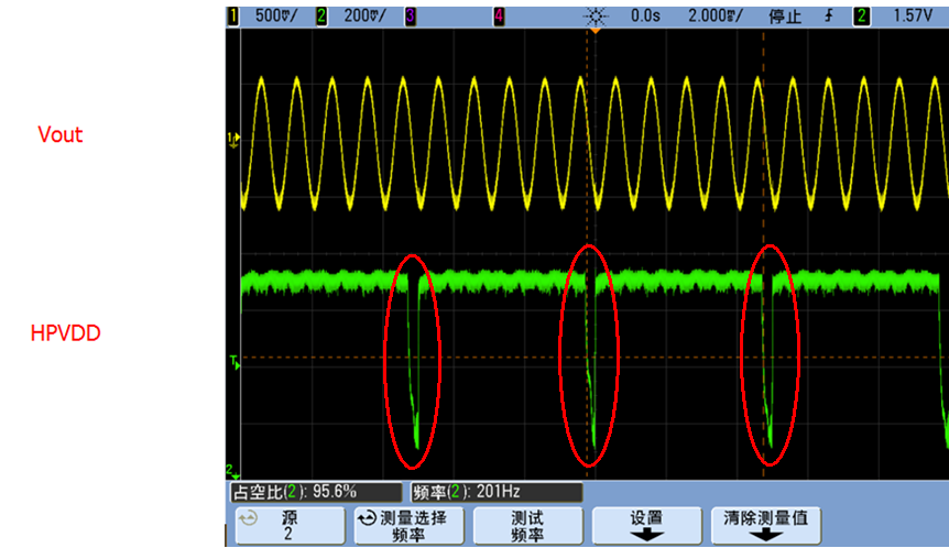

then spead the wafeform,as below,
Could you pls kindly explain how does the chake happen?

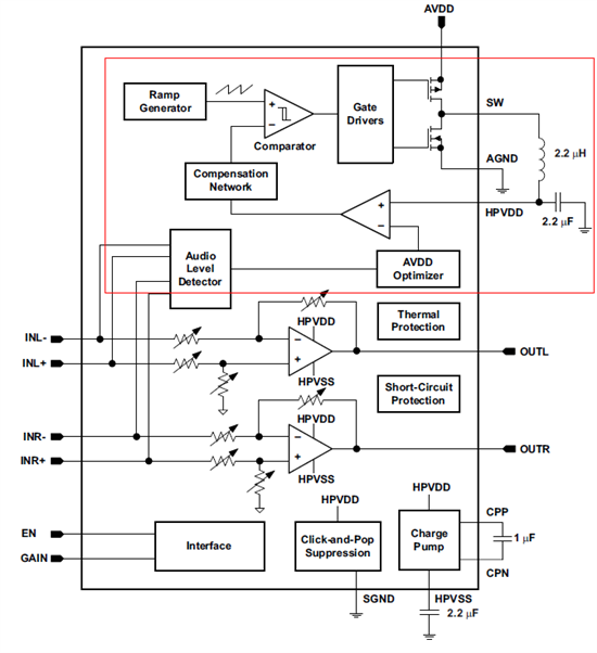

I think it is deicied by the internal power fellower circuit,and the diagram of HPVDD in TPA6141 is as following,
