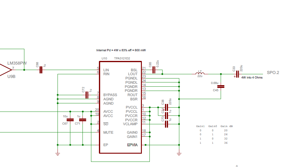

  • Here is the schematic we are using (except the -SD pin now goes to a microcontroller output).
    We set the -SD pin high about 600 mS after power up.  I can watch the charging on the BYPASS cap go to about 1.75 v which makes sense (VCC/8), our VCC is about 14 volts.  It charges in about 324 mS.  One odd thing I noticed on all our boards is that the output is always muted when I have a x1 scope probe on the bypass cap until I take it off, a  x10 probe works ok.  I can't see any difference in the waveforms between boards that are ok and boards that have the problem.  I was thinking that maybe the bypass voltage just barely reaches the limit to turn the chip on, on the problem boards, its hard to measure much difference.
    I thought maybe the output is shut down because of the output filter or something is shorted but I think that is ok.
    I do notice there always seems to be a small voltage 140 mv or so on the bypass pin even when there is no power on the board.  The strange part of this problem is that once a problem board is repowered, it works fine until it is disconnected for 5 or 10 minutes.
    I think it might be a good idea that we get a EVM board for this chip, to make comparisons with, they should have gotten one in the first place.
    Anyway are there any suggestions, or something that doesn't look right about our circuit?

  • Hi, Vic,
    Great!!! I had actually forgotten about this issue. It's a good thing you used e2e to find it!
    We had a big customer who was using this device and having similar problems. They had used an 0402-size bypass cap (1uF) and the leakage/IR of the cap was too great. We had them to change to an 0603 or 0805 cap which had less leakage (IR) and probably was also less sensitive to flux, etc, causing problems.
    I assume that you are using a no-clean soldering system. First thing I'd do is scrub the area around the cap to remove junk and see if it fixes slow boards.
    -d2

    After getting a couple of boards back that had this problem from the customer, we cleaned them by hand and problem went away.  Sounds like it is just sensitivity to contamination on that power-up bypass capacitor.  I think the board layout that was used on our unit probably wasn't the best either (there is a ground plane fill under the cap and all around the traces to that cap, maybe this made it more sensitive to contamination?  Also its connection is thru vias to the other side of the board, not right next to the pin like the EVM).  We are using 0603 size, but probably should have used 08 size like our other products use, though things were tight with space so using a physically larger cap might not have fit.
    Anyway, looks like the problem is solved !
