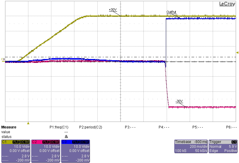

  • My interpretation from the data sheet is that current flowing from mute pin into -VEE (enables) then device.  Cutting the current flow or grounding the mute pin puts the device in mute mode.
    To test this, my -VEE is set at -15V and it is connected in series with a 5.9K resistor to the mute pins providing approx 1mA of current per mute pin.  On startup, with the mute pin connected to -VEE, the amplifier outputs is driven to the rails since my processor is not configured yet.  This suggests that it is not muted.
    Here the mute pin is floating while the supplies are coming up.  Note the "Pop" on the output waveform.
    close up of the "Pop" on the output wave form.
    Here, -VEE (-15V) is applied to the mute pin on startup.  The amplifier gets enabled.
    How can I truly mute the amplifier?
    HV.
  • Hi, HV,
    Were these scope shots made with a +/-15V lab supply that comes up with + and - outputs simultaneously?
    -d2
  • Hi D2,
    My appologies I did not explain my test setup correctly.  The +/-30V supplies are on board supplies.  The scope shots above shows the +30V supply coming up and approx a second later the -30V supply.  A -15V bench supply is used to test the mute function.  Applying -15V in series with a 5.9K resistor to the mute pins on startup generated an output as shown above.  Removing the -15V did not generate any outputs but there is the "pop".
    Best Regards
    HV.
  • Hi, HV,
    Sorry for the delay; I've been out of the office.
    What I suggest you do is power the amp from a supply that comes up simultaneously to eliminate some variables. My suspicion is the MUTE is not working correctly due to the delay in -VEE supply coming up.
    -d2
  • Hi D2,
    It seems that the mute function depends largely on how the supplies come up.  I've powered my board from an external bench supply and the pop went away.
    My on board supplies can not come up as semetrically as the external bench supply, is there any way to minimize the pop?
    Best Regards
    HV.
  • Hi, HV,
    I'm totally thinking out loud here... But, what if you tied -VEE to ground loosely thru a resistor, and then tied MUTE to ground during power up. I'm not sure if you could find a good trade-off between holding it in MUTE and power dissipation while it's running.
    I suspect the MUTE pin drains some bias current off the base of a transistor, so you just need to provide a path for that current during power-up. I suspect your -VEE is high impedance during start-up, so there is no path for the current.
    I hope that gives you some direction to investigate.
    -d2
