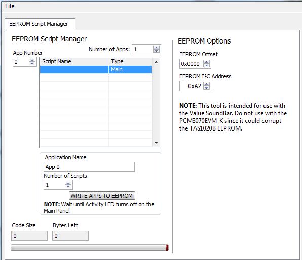

Now we are able to observe all the clocks perfectly(BCLK, MCLK, LRCLK, SCL). The problem we observed now is the MSP430 is unable to Load the data from EEPROM to PCM3070. i.e the booting is not done correctly. This is making /SD always low. MSP430 flashing was done correctly, but MSP is unable to boot codec. Please kindly Tell us where the problem is and how to recover from this issue.
Also while while writing to EEPROM it is asking EEPROM I2C address. What is the address we have to specify there. In the script the I2C address was 30(.cfg file).
Please explain us how EEPROM I2C address effect programming.
kindly please do the needful.
Srinivas. T.
Srinivas,
Looks like you're doing it right. The address is 0xA2. However, I do not see the code loaded though. You should be able to see the code size and the bottom bar filled up. See the reference guide page 10. When you load the code make sure that you double click on the blue high-lighted row. Hope this helps.
reg,
Paul.
Hi Paul,
I am able to do that. But the problem is, after writing to EEPROM and programming MSP430, the system is not sounding. We observed that MSP is not Loading the Register values to CODEC. i.e MSP is not booting the codec properly. Why this is Happening.
Also while writing to EEPROM, it is asking EEPROM I2C address. It was 0XA2 by default. But in the Script the I2C address was 0X30 (W 30 00 00). What is the significance of EEPROM I2C address.
Please do the needful. thank you.
Srinivas. T.
