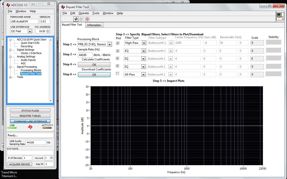

I am getting everything going, sort of. But the one thing I cannot make work is the signal processing. The software, I downloaded from your website http://www.ti.com/litv/zip/slac248b lets me control everything but the signal processing. I pick a processing block as directed, but when I try to select filter types, nothing happens. I can select a filter type, but that is all I can do. Everything else stays grayed out to further define the filter I want. Any suggestions

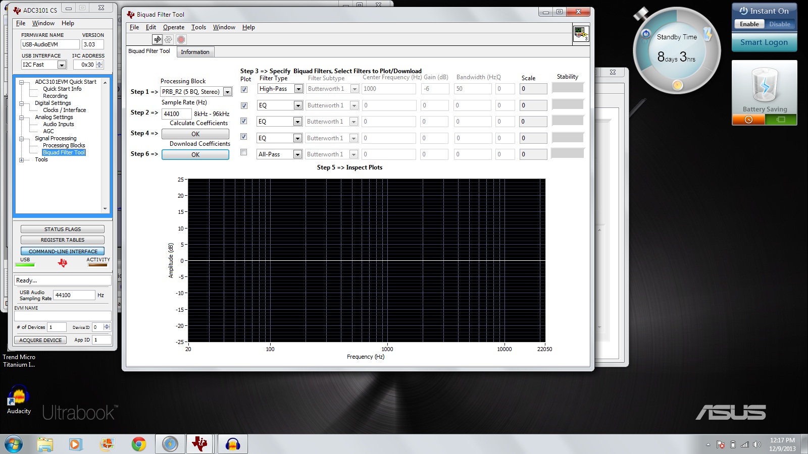

  • John,
    Downloaded it all, to no avail. Same problem
    Below is a picture of the screen showing the errors when I try to run it.

    This issue in the GUI is coming up for calculating biquad coefficients for the ADC3101. This can be done through another program found here: http://www.ti.com/tool/coefficient-calc. And following
    Page 68 through 72 in the ADC3101 d/s.
    you said you were able to reproduce the problem in the newer GUI, however the older GUI works correctly. Here is a link to the ftp for it: ftp://ftp.ti.com/pub/PPAC/TLV320ADC3101EVM-K/ADC3101_CS_v1_2_0.zip
    Let's see if this works for the customer as well, and if so, I will verify this as the answer.

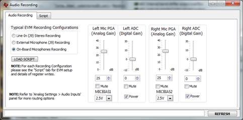

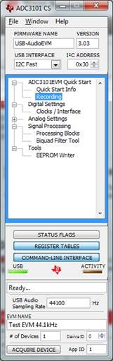

    ADC3101 GUI is run, successfully connects to the board, We can read registers, run scripts, download firmware, change EVM name, etc. successfully.
    We run the Audio Recording Quick-start and load the settings for internal microphone. Everything works, and we can capture audio from the microphones, into the PC through USB
    Then we start the Biquad Filter Tool, configure for high pass, or low pass, or anything for that matter, calculate coefficients and download, but the audio does not get affected.

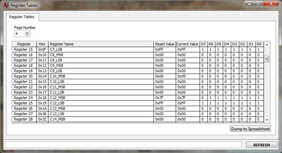

    We started examining the biquad filter coefficients that should have values written to them, according to the script captured. They were all zero, explaining why the audio was not affected. We then did a little more digging to see at what point they get wiped out.
    After loading the “Recording” script, we observed that the coefficient registers are all reset to zero’s (page 4 of the registers)
    At reset, default values, everything seems normal:
    After running the recording script. All values get wiped out and become zero
    Downloading the Biquad Filter coefficients does not seem to be able to write to those registers. In fact, using the command-line interface and trying to write a single value to register 0x0E in page 4 does not go through. Any attempts to write to these registers fails after running the recording script, unless we soft reset the device.
    After a lot of troubleshooting, we determined that it is when the ADC clock dividers are enabled (registers 18 and 19) that page 4 effectively gets wiped out and becomes “un-writable”. I cannot find anything in documentation that would suggest this is normal behavior. This gets done when we run the Recording script, which I’ve captured below. The highlighted command is the culprit. If I comment it out, then the biquad coefficients are written to the device successfully. Of course, the device doesn’t work properly in this case, since the ADC clock isn’t configured correctly.

    The main issue was in the On-Board Microphone Recording Script in the GUI - The register writes for the PGA written out of sequence.
    One thing of note is that the ADC3101 cannot change BiQuads on the fly. The BiQuad coefficients can only be modified (and seen in the GUI) when the ADC is powered down.
