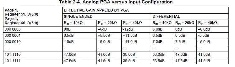

Our customer sets all of gain in the TLV320AIC3204 to 0dB by differential input.
According to attached image from TLV320AIC3204 refference guide , minnimum Gain will be 6dB when Differential input and Rin=10kΩ.
However, gain will not be 6dB in our customer. Gain will be 0dB.
Can  we  use by 6dB at the differential input and 0dB gain settings ?
If yes, are there any possibility of this issue ?

  • Hello Ryuji-san,
    The input circuit of the AIC3204 is a fully differential amplifier. This circuit has a programmable input resistor (Rin) and a programmable pre-amplifier (MicPGA).
    Setting Rin = 10k, MicPGA = 0dB and a 500mVrms differential sine wave (250mVrms per pin)  will result in full-scale (in other words, 0dBFS). If you want to do 1Vrms differential (500mVrms per pin), then you must change Rin to 20k and set MicPGA = 0dB.

  • Ryuji-san,
    The ADC full scale is 1Vrms. So 500mVrms per leg and 0dB MIcPGA Gain and 20k Rin results in 1Vrms = 0dBFS.
    <MicPGA=0dB, Rin=10kΩ, Differential Input>
    In2_L=250mVrms
    In2_R=250mVrms
    Vin diff=500mVrms 1000mVrms (0dBFS) Because IN2L - IN2R = 2*IN, and 20k/10k = 2, hence 4*IN.
    HP_L=250mVrms 500mVrms (0dBFS corresponds to 500mVrms)
    HP_R=250mVrms 500mVrms (0dBFS corresponds to 500mVrms)
    Vout_diff=500mVrms 1,000mVrms
    <MicPGA=0dB, Rin=20kΩ, Differential Input>
    In2_L=250mVrms
    In2_R=250mVrms
    Vin diff=500mVrms (-6dBFS) - Because IN2L - IN2R = 2*IN
    HP_L=500mVrms 250mVrms (-6dBFS corresponds to 500/2 mVrms)
    HP_R=500mVrms 250mVrms (-6dBFS corresponds to 500/2 mVrms)
    Vout_diff=1,000mVrms 500mVrms
    J-
