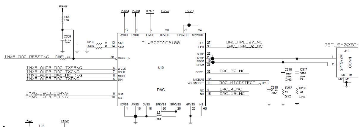

  • It's difficult to say without having access to the hardware but something causes excess current out of the speaker output pins when it shuts down. Please make sure you do not have a capacitor to GND on the class-D outputs (some designers may add those to filter out high frequencies).

    1. Audio Playback problem at high volume
                       Please find attached my schematic for your review

            A). We have ordered the TI-EVK for the DAC and Interfaced it to our custom board by bypassing the on-board DAC, with this setup
    and our SW we are able to play audio continuosly at high volume without any issue.
            B). We have also eliminated the possible issues related to power by wiring all the power signals from custom PCB to TI-EVK.
            3817.TI_TLV320DAC3100_layout layers.docC). We now suspect the issue may be related to our PCB layout, we need your support in analysing and point the problem in the
    attached layout files.
    Thanks and Regards
    Vivek
  • I think this was resolved by removing R265 and R266. Please confirm.
