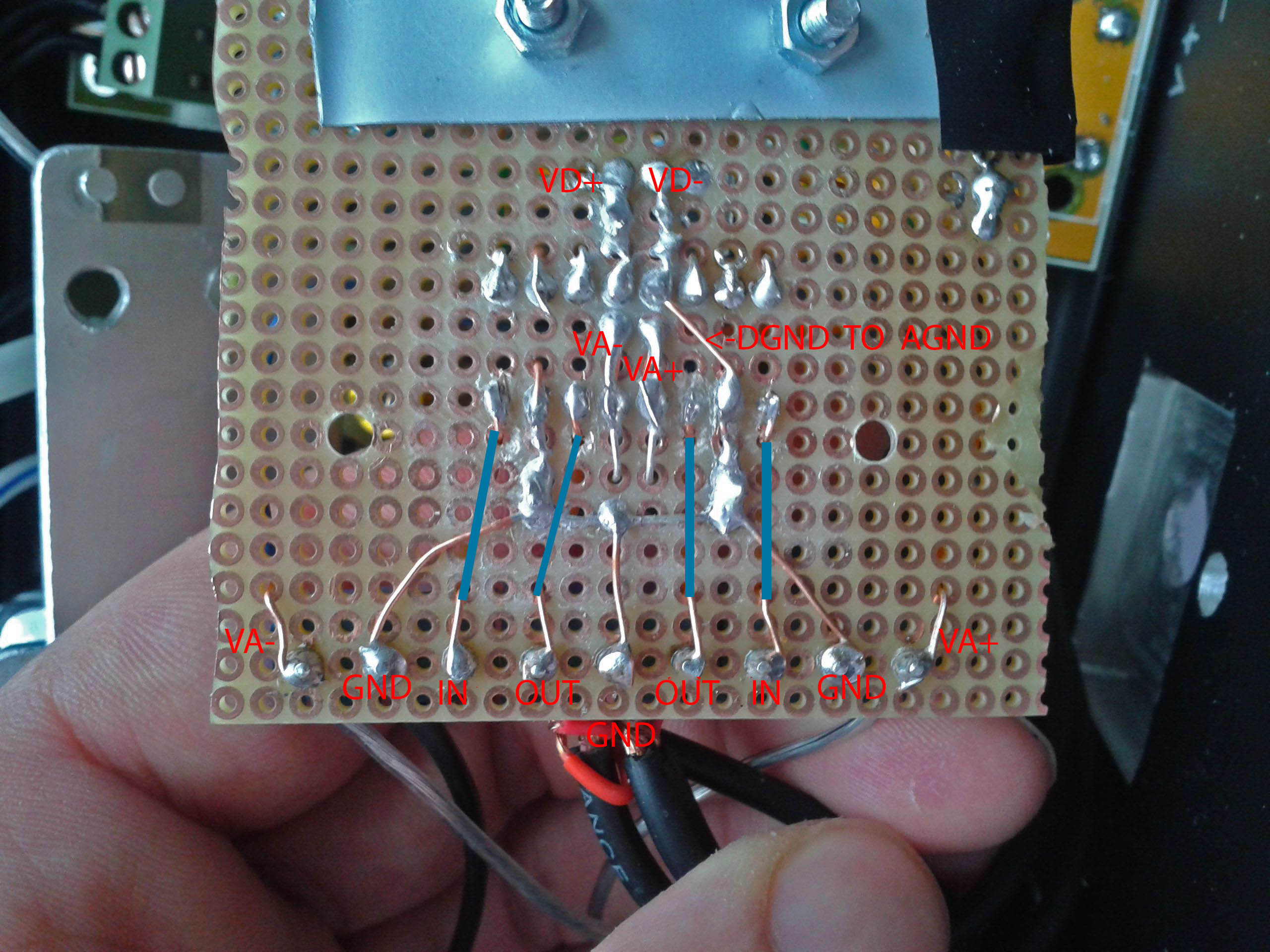

I recently have got one of this reputable volume control chip.
I built the circuit following every step in the datasheet.
AGND and DGND are connected tight together.
Connect this circuit to my damn quiet amplifier, it becomes horribly noisy, a lot of noise floor in spite of that datasheet states the chip as a low noise one. When its input is shorted to AGND I can hear the noise even at a 3meters distant!
Besides, the datasheet also states that this chip has a feature of noise-free level transitions, however when volume level is being changed, I hear a pop effect like "tic-tic-tic".
I tried to supply the circuit by battery, but no change.
Please give me any idea how to reduce noise to an acceptable level.

  • Dear John,
    I wouldn't think that layout could go so wrong. I tried many way to remove noise.
    I now follow star ground topology, which works perfectly in my other audio stuffs, such as LM3875 amplifier and my headphone amplifier, as well.
    For PGA2310 the star ground point is the common pin of the two 10uF capacitors. From this point leads the pin10 and pin15 through seperate wires. Also this point is connected by a short wire to the pin5.
    It is just too simple to screwed up.
    As for the input, intresting thing that there is no difference in noise if input is shorted to the ground or not.
    I haven't tried using EVM because I thought it is very simple to make PCB for it (only 6 capacitors). But now I would be interested if the EVM could solve noise issue, or the chip is not good enough. But EVM board is too expensive for me.

    here are the pictures of my circuit. Ii is unnecessary to attach the schematic because it is the same as in the datasheet.
  • Hi Feri,
    Unfortunately, a noise problem in a hand-soldered board is tough to solve; remotely even harder. I recommened taking Ian up on getting the EVM and modifying that for use in your system.

    Anyway, what is your experience with setting PGA2310 gain over 0dB? As for mine, the noise is increasing significally, and over +20dB the noise is so strong as if it was raining heavily. (if you need, I have recorded it)
    Feri
  • Feri,
    I am also an audiophile, though I don't have experience on PGA2310. However, take a look at the PGA2310 datasheet, you can see the noise @ 0dB is 9.5uVrms. When you set gain to 20dB, the noise will likely increase to 95uVrms, a high enough value for headphone. If you amplify it further using amplifier, the noise will be obvious.
    From my experience, to get the best performance, you should set the input signal to high amplitude and the gain of the following amplifier to low value, since the signal quality (SNR, THD+N...)normally is better at high volume (just before clipping occurs), while the amplifier with feedback becomes better at low gain.
    Now return to your case, if you use 2Vrms line out signal as souce, and set the PGA2310 gain to 0dB, the SNR @ PGA2310 output can be calculated to be 20*log(10,2Vrms/9.6uV) = 106dB. A very good figure. Even if you use the around 500mVrms MP3 or mobile phone output, the SNR is still above 90dB, still a goo figure.
    If you indeed need a x10 gain stage, and can't tolerate the noise of PGA2310, I suggest to build one x10 amplifier using low noise OP and put before PGA2310.

    I think Frank was right. I ordered a PGA2311 as a sample and replaced my PGA2310 with it, and noise almost has gone!
    I think it is because of the 9.5uV output noise of PGA2310.
    PGA2311 has 2.5uV noise and it seems low enough to hear almost no noise at all.
    After that, at the beginning I told that PGA2310 is too noise. Time has proved it true.
    Anyway, Thank You very much for your help!
