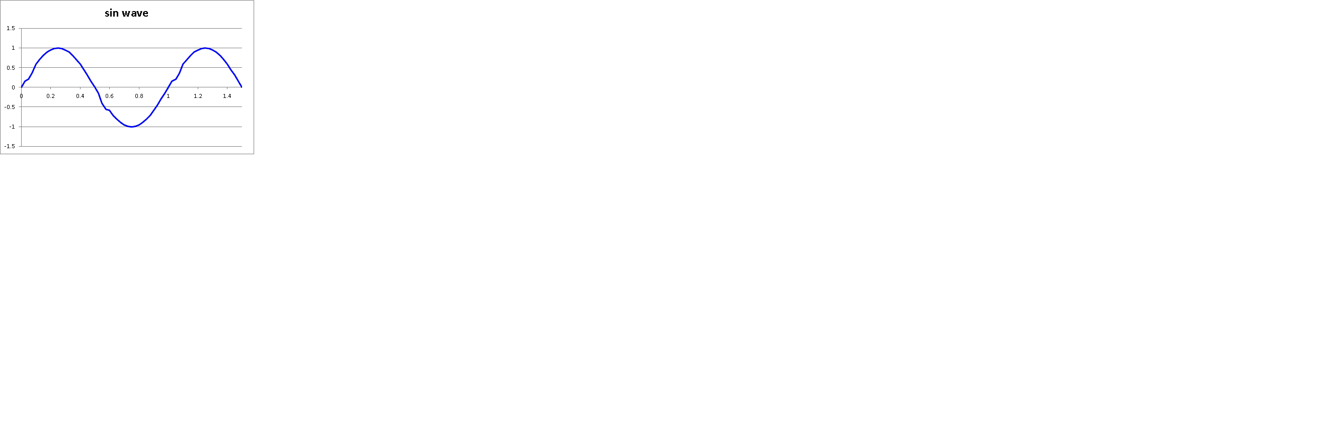

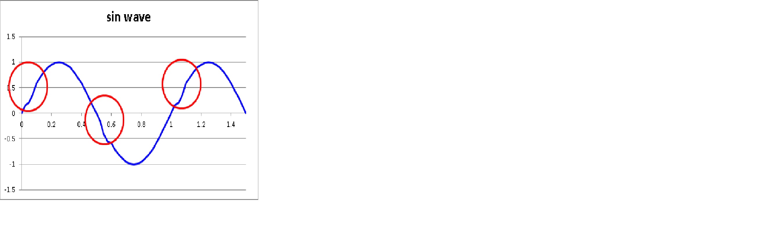

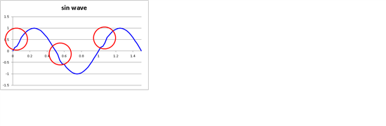

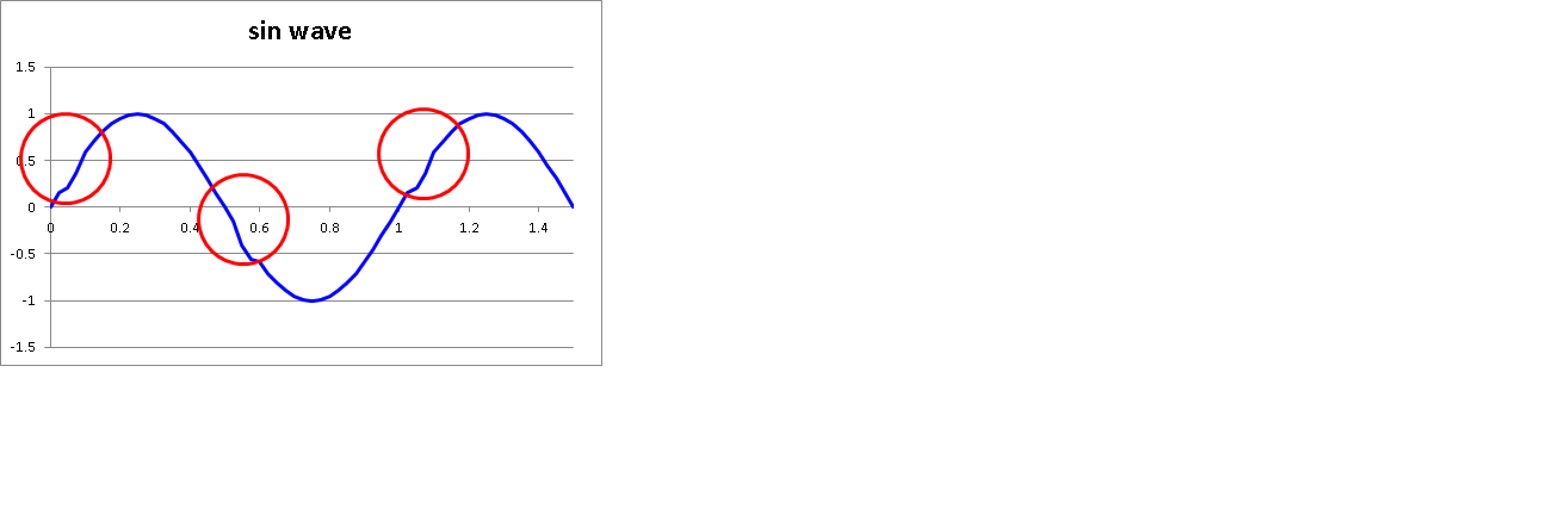

I was asked about a wave distortion of TPA6130A2 from my customer.
They inputed 1kHz sin wave to it,wave distortion arose as a red sphere of below wave.
I wrote a distortion overly,in fact,THD is approximately 1%.
Is this an essetial characteristic of TPA6130A2?
They set  the RC LPF(18Ω/6800pf) to output.
Cut-off frequency of RC LPF is about 1.3MHz.
Wave amplitude is about 1.2V.
This RC LPF affect a distortion ?
Best regards.
  • Hi, Noda-san,
    This does not seem correct. Something is wrong.
    I don't think the RC should cause this problem, but maybe you can try removing the cap and see if the THD improves?
    Otherwise, it may be a layout issue - can you verify the operation on the EVM?
