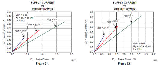

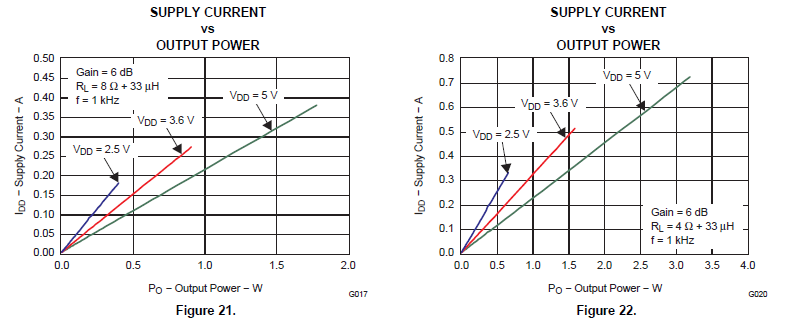

I am a bit confused on the power supply requirements for the TPA2028D1. The charactersitics sections says it will need up to 2.7 mA at 3.6V - this seems a little too good for 880 mW. The graph looks like it will need 270 mA - but I  get 972 mW.   What is the correct current demand for 2.5/3.6/5V?
