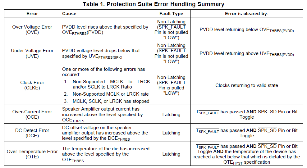

We would like to know the detection method of clock errors.
The condition of clock errors is described on page 34 of TAS5760M data sheet.
Could you please tell us each error detection method in detail?
For example, if the clock stops, how many seconds is it necessary to detect the clock error?

    As discussed in our meeting page 34 table1 of the TAS5760M d/s summarizes the clock error handling.
    During a clock error event e.g. SCLK stop then start, the output takes ~1us to shutdown and 1ms to resume. It takes ~35ms for the output to resume to the volume level before the clock error occurred. This time will vary depending on volume level setting as explained in the Digital Boost and Volume Control section on page 32 of d/s.

    Could you please give me the conditions of each error detection on page 34 of data sheet in detail?
    (e.g. the combination condition that an error is detected, the threshold values that a clock stops and becomes the error, time before an error is detected, time before an error is cleared, etc.)
    Kato
  • Kato-san,
    We discussed this in our face to face meeting last month. It's a set of counters and if count varies from one cycle to the next  on any of the counters it triggers a clock error. The table in the datasheet is very clear on the conditions that will trigger the clock error.
    1. Non-Supported MCLK to LRCK and/or SCLK to LRCK Ratio (1fs to detect error and 40fs to clear error)
    2. Non-Supported MCLK or LRCK rate (~1us to detect error and ~1ms to clear error)
    3. MCLK, SCLK or LRCK has stopped (~1us to detect error and ~1ms to clear error)
