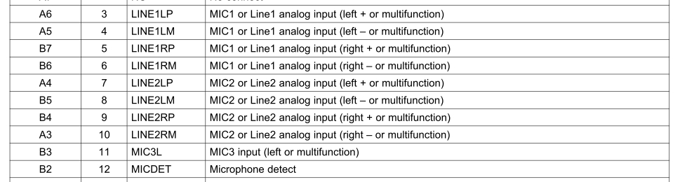

    I can't find the electric criteria/define  of  Line In/LineOut /Mic In  audio codec (AIC3106).
    Datasheet describe the Line In/Line Out/Mic In  pin as below.
    Each EVM's audio codec connect Line In / Line Out / MIC In  in different way.
    Some, design it with compensation design......  Some not......
    Want to know more   Line In / Line Out / MIC In  Pin define/specification.........
