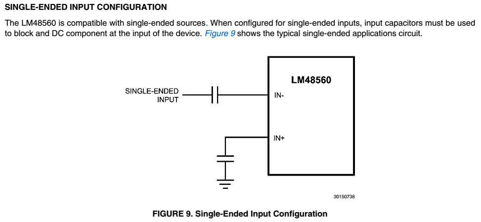

My customer who uses LM48560 with differential input is now trying to change their circuit to single-ended input.
It is stated in the datasheet that, for single-ended configuration, DC block cap and a cap for unused input.
Q: How can we figure out the value of a cap for unused input? Is it necessary to use same value with DC block cap?
Q: Also, is it possible to connect unused input to GND without any cap?
Q: Datasheet suggests to use IN- for single-ended input, but is is okay to use IN+ instead?
Thank you for your support in advance.

  • Hello Kenichiro-san,
    I'll make some comments to your questions about single ended input.
    Ans: Yes, you need to use the same value with DC block cap
    Ans: No, to keep the same DC bias for both In+ and In-, you need to use the same cap value for unused input side.
    Ans: You can input the signal to IN+ via DC block cap and IN- pin need to use the sama cap value to GND.
    Please note that if customer use ALC function in differential inputs, you will keep differential inputs configuration to work ALC function well. But when you take single ended input configuration, ALC function doesn't work well.
