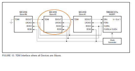

  • Hi,Prachi,
    SRC4190 TDM bus application is serial.Just as the picture shows:
    If one of the slave device can't get the data form the previous device,this device can't talk to the next device,too.

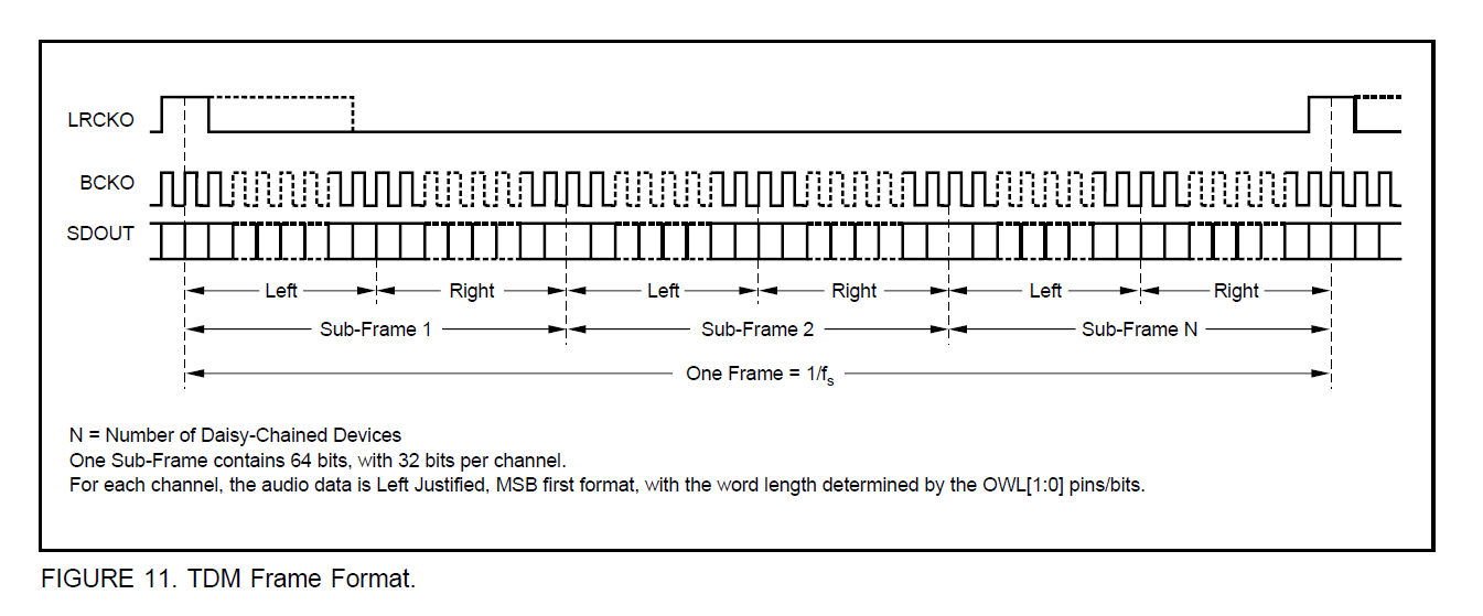

  • Hi,Prachi,
    Let's see the TDM fomat.
    The TDM in the audio is actually PCM in time division.
    PCM don't have any CRC or report error,it's one way ,just pass the data.
    So if the data is lose,I mean the input data is zero or no input, TDM is output,it can't do anything for the data.

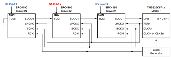

  • Dear Flora,
     Thank you very much for your quick reply.
    I have explained our use case in more detail. I hope this clears any misunderstanding.
    Our use case is as shown in the below figure.
    When all three audio sources present, the processor will receive the 6 mono channel TDM data from the SDOUT pin of Slave #1.
    Please confirm.
    Now, if suppose, the audio input to Slave #2 is not present.  Both the I2S input data and the clock is not present for Slave #2. The input to the Slaves #1 and #3 are still present.
     In that case we believe that processor still receives data in 6 channel TDM mode. The slots corresponding to Slave #2 will not contain any data.
    Please confirm
    Prachi

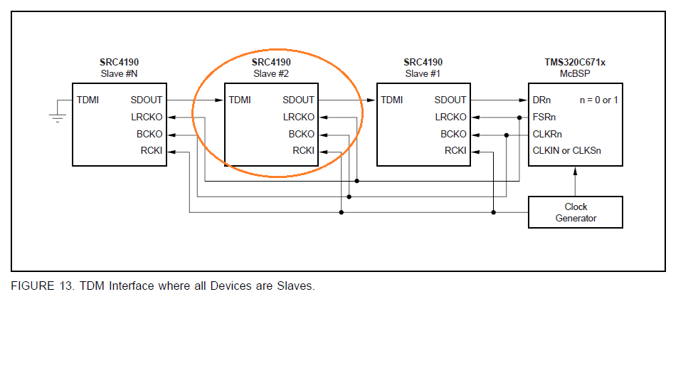

  • Hi,Prachi,
    Thanks for your patience. I am sorry for my misunderstanding.
    Now I understand your concern.
    1.You are right, the processor will receive the 6 mono channel TDM data from the SDOUT pin of Slave #1.
    2.if the CLK(BCKO,LRCKO) of slave 2 is not present,there I think the processor can't have the data of slave1 and slave2. Because the TDM can't work without CLK.
    3.if the CLK is right,but just lose the data of slave 2,the processor will have slave 1 and slave 3 data. Slave 3 can find the their own slot by countig the clk,so we must make sure the clk is right.Then it will be no impact to the next sub frame.
    Flora Wang
