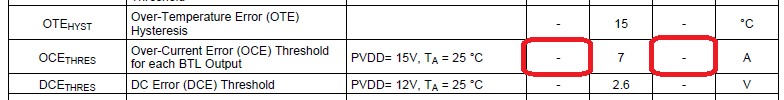

Could you please tell us minimum/maximum values of the over-current error threshold as below?

Kato-san,
The TAS5760 OCE threshold is ~ 7A+/-1.2A.
