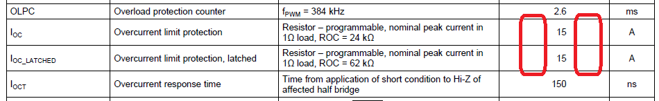

Could you please tell us minimum/maximum values of the overcurrent limit as below?
Your prompt response would be really appreciated.

Hi Kato-san,
There is no min/max spec guarantee for the over current threshold. However, the variation is expected to be within +-6% by design. The OC threshold is measured by 1KHz burst signal into 1 ohms load. Burst signal is used to provide accurate and repeatable OC threshold measurement by prevent heating of the output FET.

Hi Paul-san,
Thank you for your quick reply.
Since we understand that you can not guarantee minimum/maximum spec of the overcurrent threshold, we will inform our customer that the target value of design is within +/-6%.
