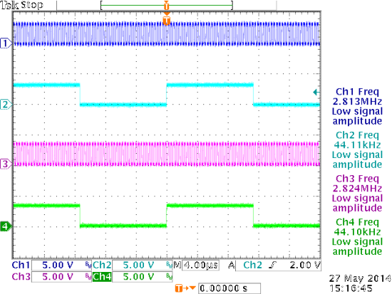

    The BCLK and WCLK when AS1 and AS2 are set the clock master is below.
    Is the SystemSettingsCode property setting of the framework necessary
    even if executing the cfg file at the reset?

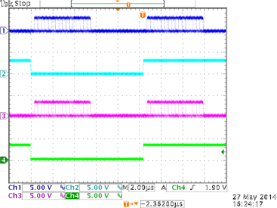

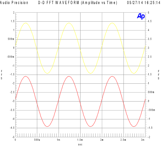

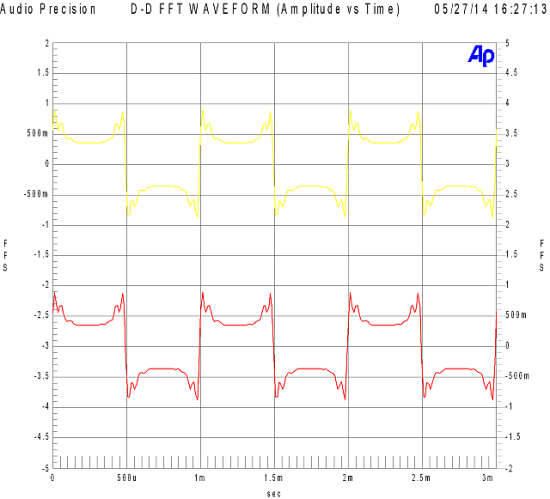

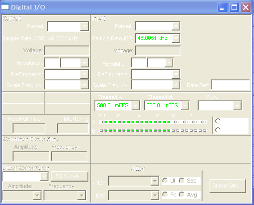

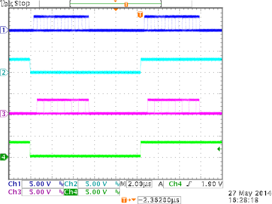

  • J Arbona-san,
    I took the data more in EVM.
    Are the following the result of not to set the SystemSettingsCode property of the framework?
    The data are not transferred from AS1 to AS2 definitely. A sign bit of MSB seems to be missing.
    The Digital I/O window of Audio Precision.
    AS1 and AS2 wave form.
    blue : AS1 Data Output
    cyan : AS1 WCLK (master)
    magenta : AS2 Data Output
    green : AS2 WCLK (master)
    AudioPrecision FFT Waveform of the AS2 input data
    The signals when PSIA output to input loop-back are shown below as reference.
  • J Arbona-san,
    The AS2 Data Output must be the same as AS1 Data Input signal.
    Why do the data not accord?
    Will the registers setting be wrong?
