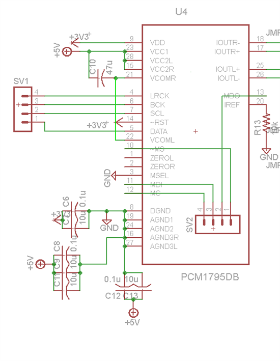

Hello, I 'm a new user of PCM1795 and this forum. I would like to use SPI to read and verify registers using Beaglebone black SPI, but the readback is unstable(readback word is not what was command to write) . The circuit diagram is attached. SCL is made by the McASP pin P9_25 of the beaglebone black. the remaining SPI is connected to SV2. Please help

    Welcome to e2e, and thanks for your interest in our products! I haven't personally used this combination, so hopefully someone in the Community will chime in with their experience.
    In the meanwhile, the first thing that comes to mind is voltage levels. Since the PCM1795 runs off 5V, the logic thresholds on the digital pins are TTL levels. Maybe the BeagleBoneBlack can't output TTL logic levels?

  • since from specifications, input voltage for digital input range from -0.3 to 6.5V, I'll take 3.3V as acceptable level?
  • Hi, Sum,
    The PCM1795 recognizes a logic low as any signal less than 0.8V, and a logic high as any signal greater than 2.0V. In between those values, is an undefined state, and should be avoided.
