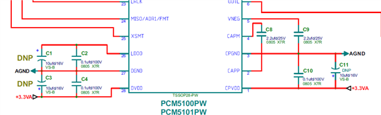

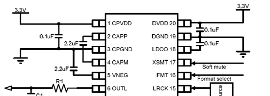

  3. I have noticed that the schematic of the PCM5102 EVM differs slightly from the recommended schematic on the datasheet. The EVM schematic contains what I believe are decoupling electrolyctic caps and ceramic caps on the power supply, while the datasheet only has ceramics.

    Should I follow the datasheet or EVM implementation?

    On the Evm schematic, the electrolytic caps are labeled, "DNP" which stands for Do Not Populate. So, if you were to buy an Evm, you would find those components are not actually on the board. so, I believe the ds and evm align.
