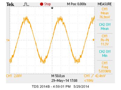

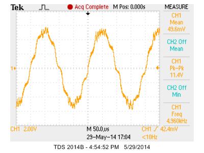

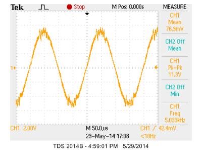

However when I use miniDSP for signal processing, high frequency (>5000Hz) signals get distorted. (as shown in the image bellow)
I think this is a issue with the clock settings used for CODEC_CLK_IN.
My application requires the use of the miniDSP.
Could you please provide me with a solution for this.

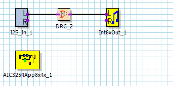

    However my actual project requires, getting audio data through I2S and doing audio enhancement and outputting through analog interface. Therefore would the following be correct with the AIC3254App8x4x framework?
    I2S_In -> Audio enhancement blocks -> Int8xOut
    Or am I missing some other point here ?
    Thank you
    Niroshan
  • Hi,Niroshan,
    Yes,you can do it in PPS like this:
    You don't need use DSP_D_DSP_A,this componet is used for passing data from miniDSP D to miniDSP A.But currently you only need DAC,so what you only need use miniDSP in DAC.

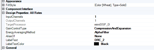

    When you cilck the DRC,it will show:
    See you are using miniDSP_D,if you are using miniDSP_A,it will report error after you connect and download it.
