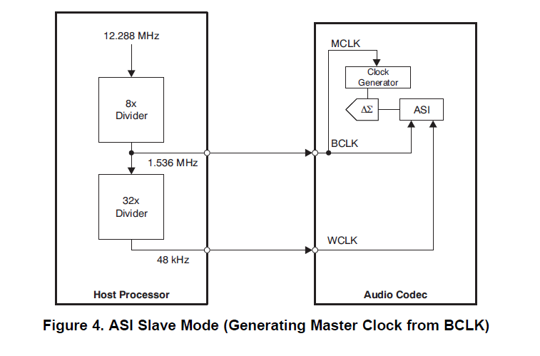

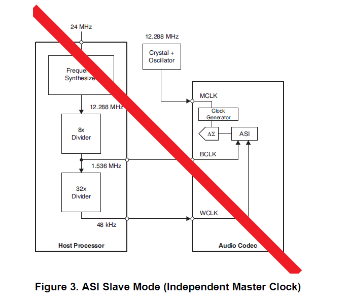

MCLK for TLV320AIC3120 slave AIC
I want to connect to GSM modem audio digital interface with fs=8kHz , GSM can work only as master on digital audio interface and can generate only 256kHz BCLK. I am using AIC3120 with independent MCLK source for example 12Mhz with digital audio interface wit BCLK,WCLK as inputs. From app.note I have got information that in slave mode the MCLK have to be "frequency locked" to BCLK  (does it mean that have to be MCLK/BCLK=const.?) . Is it possible to my configuration work right ? I have no possibility to change anyway audio interface on GSM.
