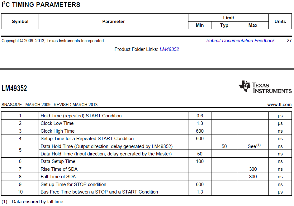

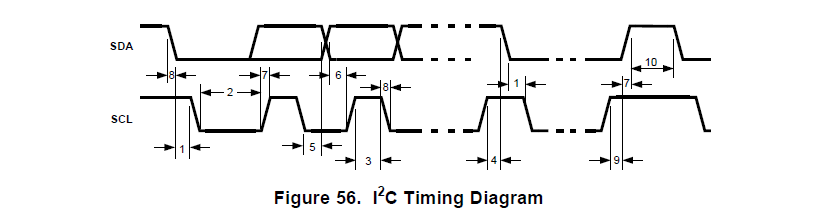

Their LM49352 datasheet has no timing information for the I2C interface, only an overview of bit locations. Can you please provide setup/hold etc. to do FPGA work on that interface.
Hi, TI Lady,
This device is fully compatible with Philips, no, NXP, I2S specification.
-d2
Hi A..
In ESP, there is an App Note for interfacing with i2S: Interfacing an I2S Device to an MSP430 Device (Rev. A) . The format acceptable is shown in the LM49352 datasheet Fig 64.
~Leonard
Hi, TI Lady,
Sorry to confuse you, I was trying to be funny that the i2c and i2s specifications were originally authored by Philips Semiconductor, but about 10+ years ago, Philips spun off their IC business to NXP.
So, yes, this device is fully i2s compliant. Does your customer have an issue, or did they just ask for an i2s codec? Because, if that is the case, we have better choices than this one.
