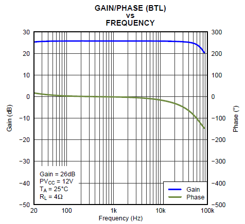

We found that there is mentioned the measurement data of the frequency response on page 9 of TPA3116D2 data sheet as below.
Although the frequency range depends on coefficients of LC filter, can we increase this frequency up to 40kHz as the passband?
In addition, should we set switching frequency above 1000kHz?
