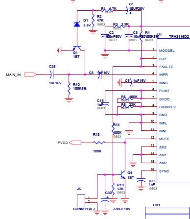

    The schematic on the connection of TPA3116D2 to Transformer is as follows.
    I hope that you give me a transformer design solution for avoiding the saturation of transformer.
    Thanks for your help.

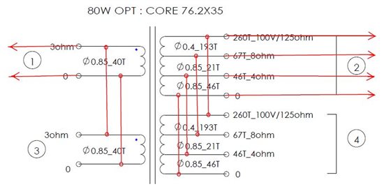

    Each terminal of transformer is connected to each speaker load as follows. (one by one)
    The 4 terminal of transformer is connected to the 4 ohm speaker load.
    Or the 5 terminal of transformer is connected to the 8 ohm speaker load.
    Or the 6 terminal of transformer is connected to the 125 ohm (total parallel speaker impedance) speaker load.
    Also, the signal level and frequency when SCP triggers, will reply as soon as I have received my customer's data.

    The setup appears correct.  So the interface with the transformer must be the problem.  I have a few ideas to try.
    1.  Do not parallel the windings on the transformer and try only one primary winding and one secondary winding.
    2.  You can try the primary windings in series instead of parallel.  The impedance will be mis-matched, but this is for experimenting only.
    3.  What is the part number and manufacturer of the filter inductors?  Send a datasheet if possible.   If these saturate, this can cause this type of behavior.
