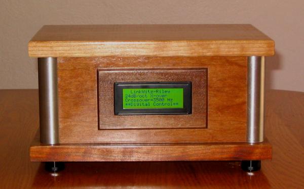

  • Thanks John: Here is an active x-over(2-way) that I built about 10 years ago,I used digital pots(8 bit) for all frequency determining resistors controlled with a PIC,works really well it was hand wired.....I like yours better !
  • That's awesome! The final product looks really clean, very well done.

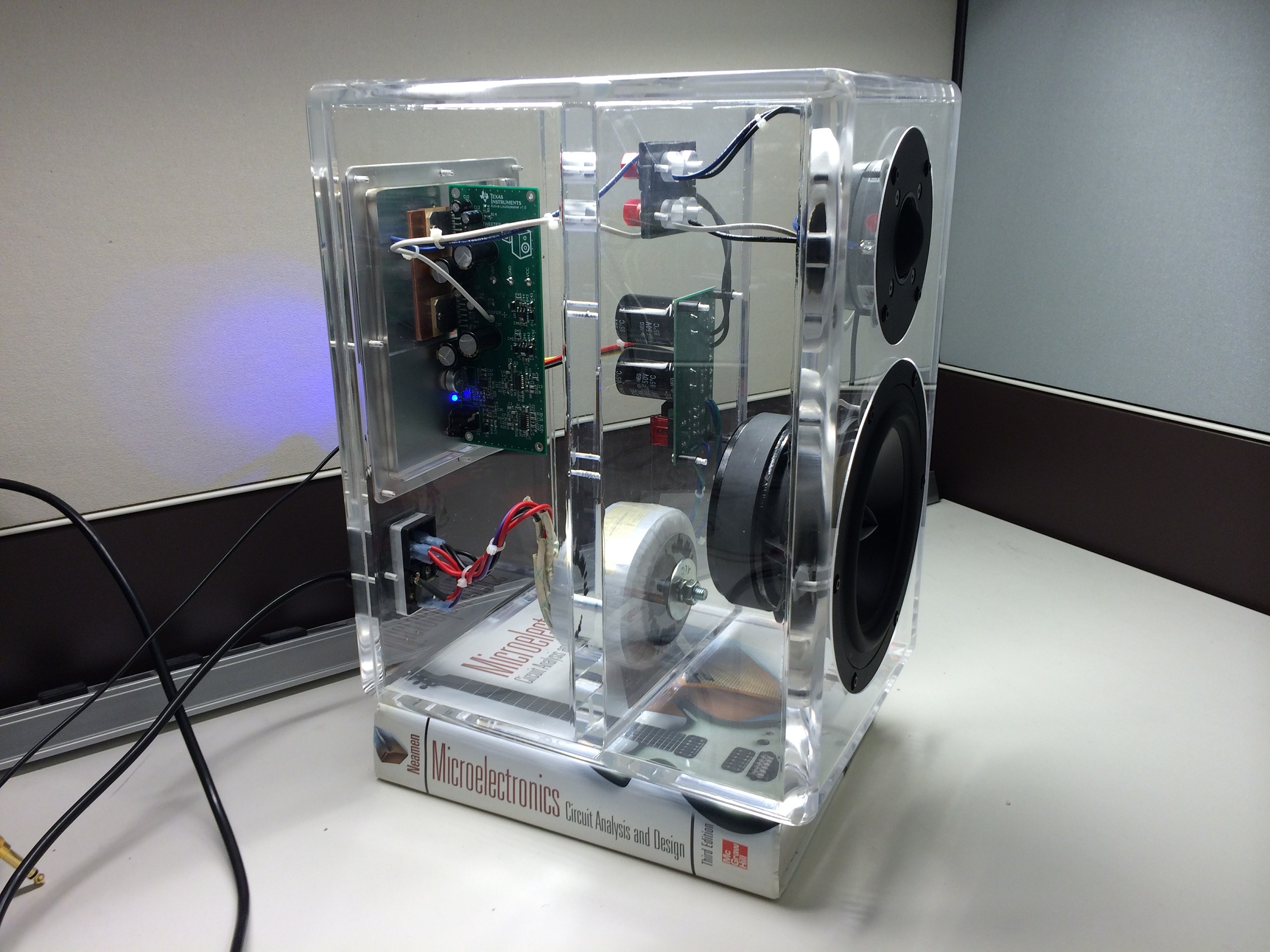

    I'll post my own picture for show-and-tell:
    This is a two way powered loudspeaker using the crossover circuit I detail in that article. The outputs from the crossover circuit go to LM3886s which power each driver directly. I designed the enclosures and then worked with a plastic's company here in Tucson to fabricate 4 of them so we could take pairs to trade shows for demos.

    Thanks for the kind words on the speaker. I have 4 of them right now taking up a huge amount of my desk space here at the office and they are a constant distraction for people walking by!
