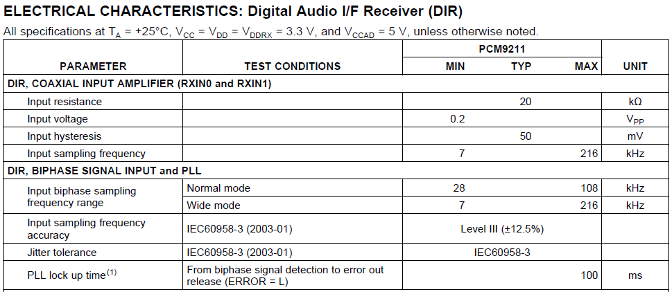

PCM9211 Rise and Fall Times of DIR
Since the rise and fall times of dir are not mentioned on page 6 of data sheet as below, could you please tell us these specifications?
For example, if the rise and fall times are less than 0.4 UI, is this device able to receive the S/PDIF source completely?
Although we use 3.3Vpp as the input amplitude, we are worried about the operation at 192kHz.
